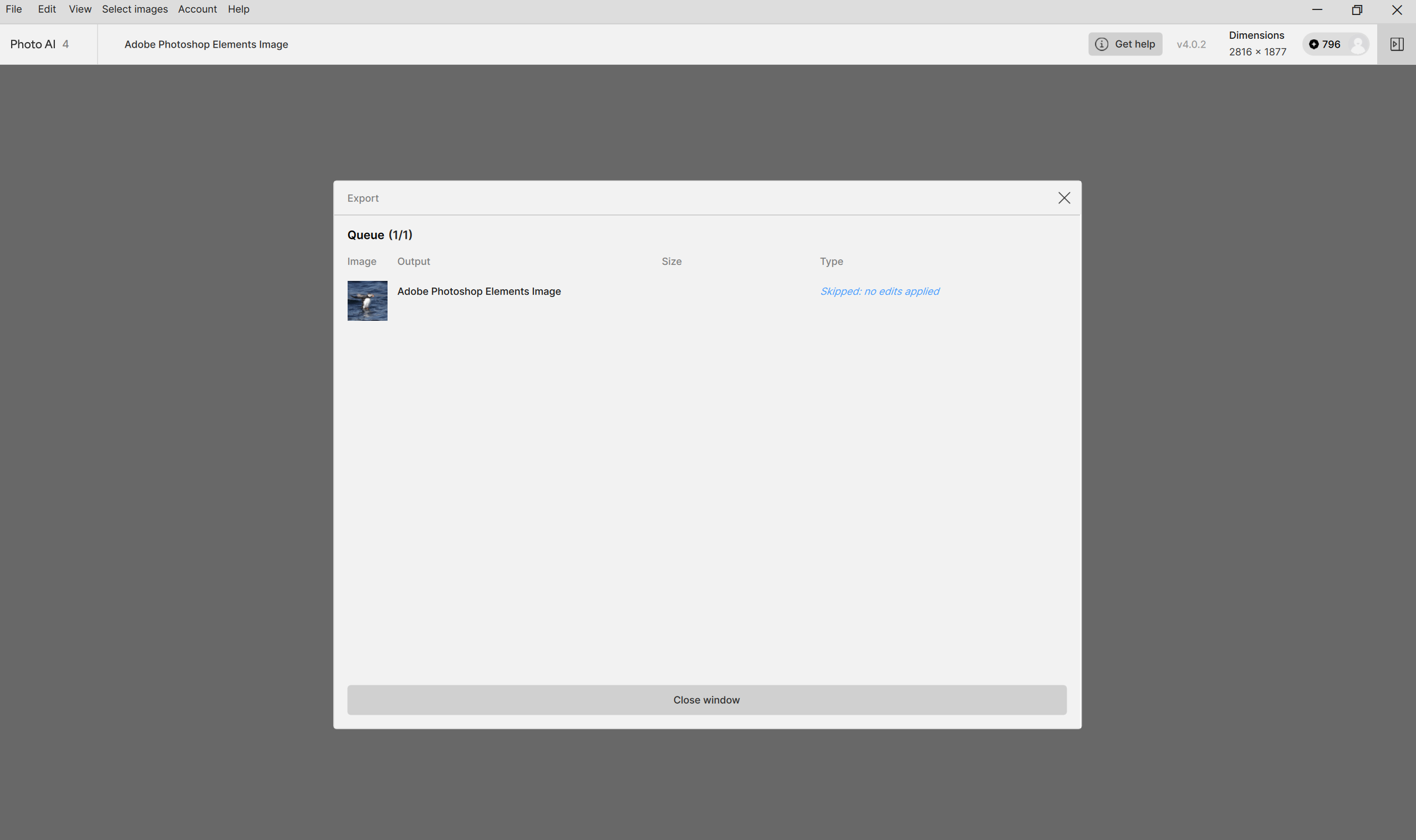

(separate issue - an “Export” window always opens, which I have to close before getting to edit the image - not sure if that can be switched off?)

Hello! For this part, can you send a screenshot of it?

Hi Ange - regarding the Export window, the attached is what opens immediately after I open an image in Topaz from within PSE (and after the Autopilot runs, but only for the second and subsequent images - it doesn’t do the first time I open an image in Topaz from within PSE.

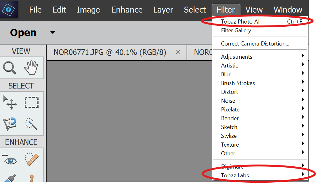

@Ange.topazlabs - think I’ve narrowed down the issue with the Export window popping up. It only does so when selecting the most recently used filter in PSE, either by clicking on that or using Ctrl+F (the top red ring).
Using the link to Topaz at the bottom of the list (the lower red ring) works fine with no Export window popping up.
That is correct, that is the Adobe shortcut for the last Filter used, that is not meant for this party apps. Its meant for short/small in app pligins within Adobe. It has a “timer”, very short, which ddoesn’t even let Photo AI analyze the file. To use the Topaz Photo AI plugin further down the list, not the Last filter used shortcut.
