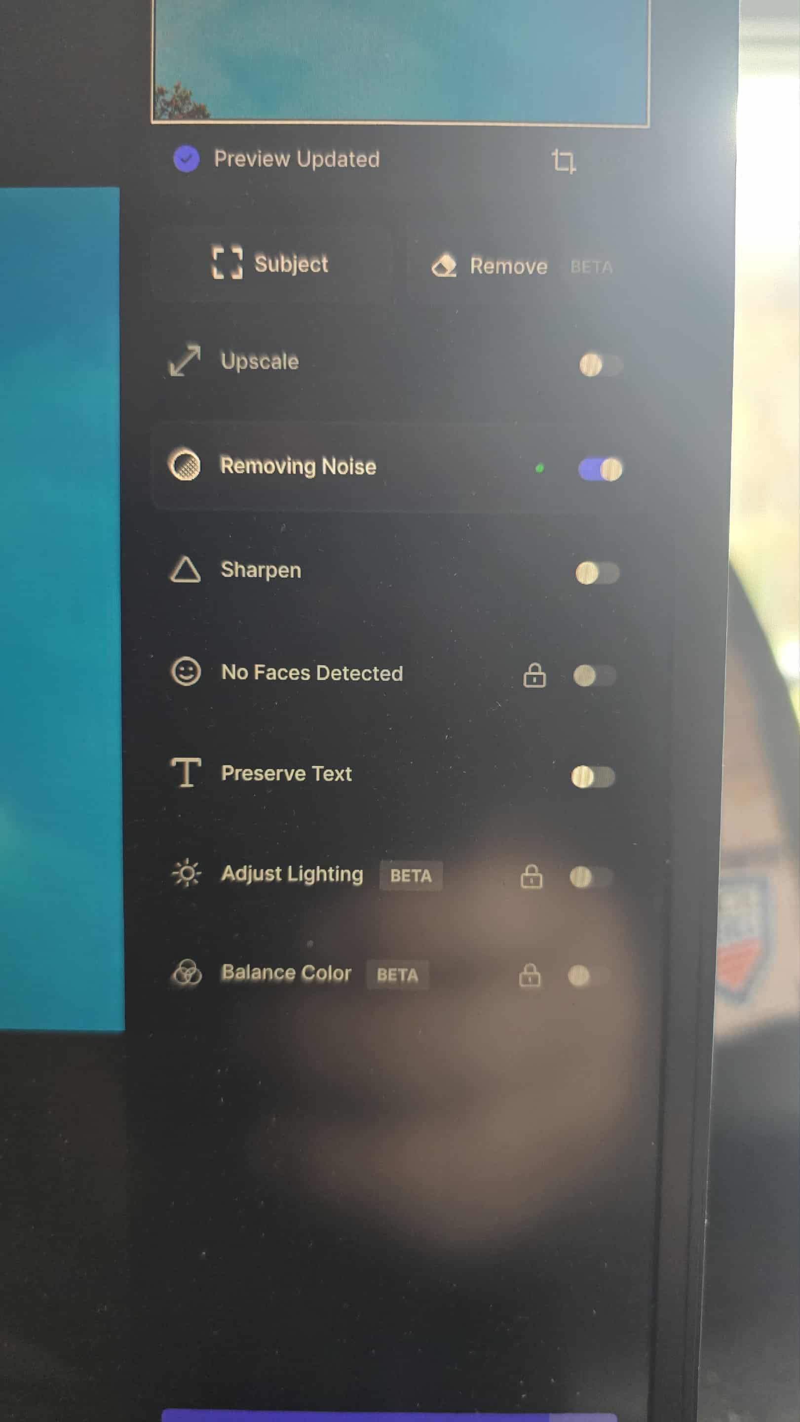

Yes, Im shooting RAW all the time. Here is the Topaz Im using. It doesnt show a RAW Denoise tool. Am I using a older version? Maybe I should upgrade. Is there a charge to upgrade to the version that has the RAW Denoise Tool?
(attachments)
This is a much older version of Topaz Photo AI possibility version One or Two also, you’re not showing the top of the Image so, we can’t the information for the file.
Basically, we need to see the whole Image including settings is it possible to post a screenshot if not then, a phone image including settings of the whole screen will have to do.
