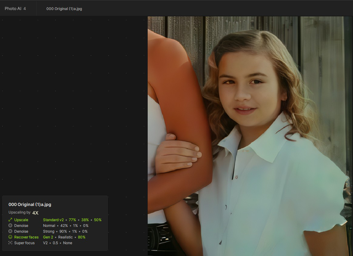

For the purpose of this exercise I will be using Photo AI 4.0.0 to show Randall that it is a perfectly good program.
I use Photo AI as a stand alone on Windows 11, using an under powered laptop regarding Low Vram, as I’m always being reminded by Ange.
Processes:
I opened the “000 Original (1)” picture in Affinity Photo 2 to repair the damage to the girl’s hair by using a clone tool and blur brush so that it matches the softness of the rest of the picture.
The back of the girl’s left arm is soft and indistinct and will cause problems later if I don’t fix it. Again I use a clone tool and blur brush just to firm it up.
The Clone Tool and Blur Brush are simple tools to use and you don’t need to be too precise as Topaz will blend them in when it processes the picture.
Saved the picture as “000 Original (1)a Repaired” and closed it and Affinity.
Open the “000 Original (1)a Repaired” picture in Topaz Photo AI using the settings as shown in the “007a Topaz Settings” picture (Below). Starting with Super Focus first and working UP the list. All the settings except those of the two Denoise filters were set by Topaz.

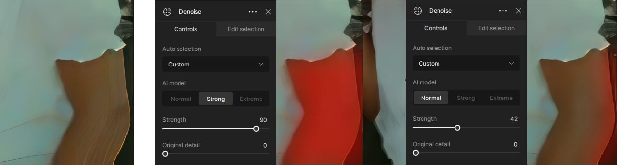

The picture “007b Mask Settings” (Below) shows three pictures the first one shows a striation that has occurred on the girl’s arm during processing despite my efforts in Affinity. The 2nd and 3rd pictures shows the masks I painted in and the Denoise settings used as shown in picture 007a Topaz Settings to remove the striations.
NOTE: The second and third pictures shown in the 007b Mask Settings file, shows the masking that I applied in RED to the girl’s left arm in order to remove noise from her arm only. Only these areas will be Denoised when the filter is applied. To apply the mask click on the arrow next to the AUTO SELECTION and select CUSTOM from the pull down list. Next click on EDIT SELECTION and use the Paint /erase brush to paint in the area that as shown. After that select CONTROLS and set the denoise amount.
Export Export and Save the picture and prefix its file name with 007c
And there you have a reasonably good picture with an ok hand.
