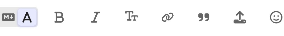

Would be possible to post a before and after images here’s how after you Click on the Reply button and the Reply Window has opened you’ll see a few symbols along the top
One of these symbols has a small box and an Arrow pointing up
Screenshot_2025-11-08-03-44-44-02_40deb401b9ffe8e1df2f1cc5ba480b12~4 Click on this symbol and select Media Picker then, navigate to your Pictures find your desired image and simply Click on it to upload.
That’s the official way of posting images here however, you can simply just Copy and Paste your image
