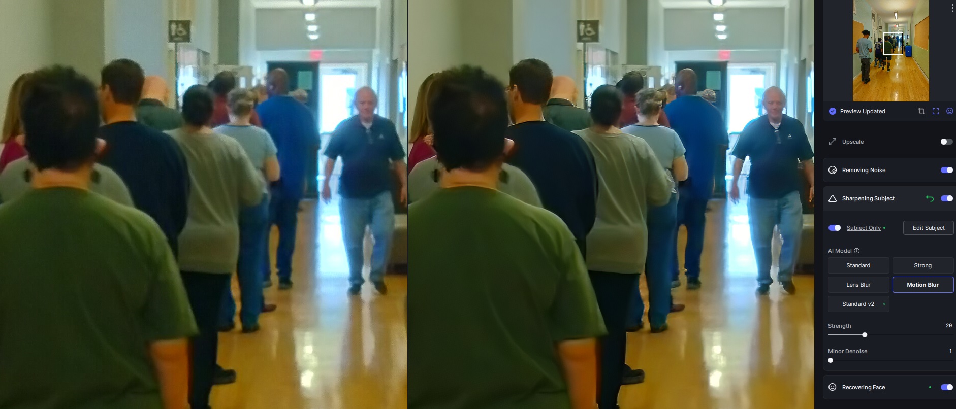

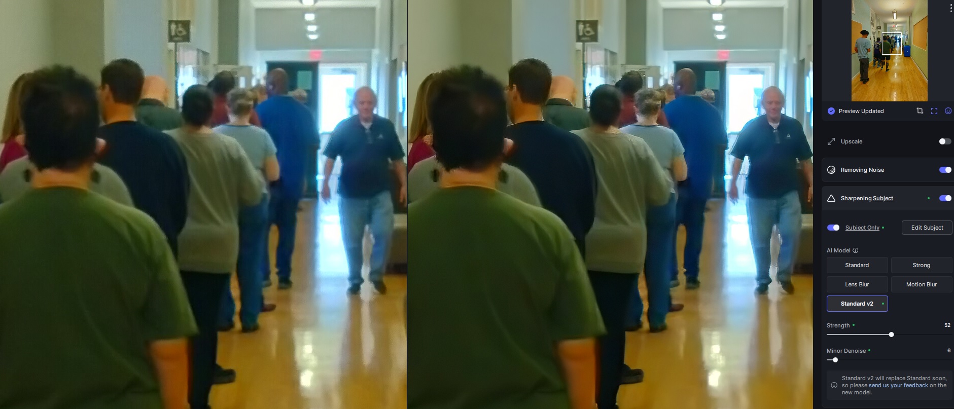

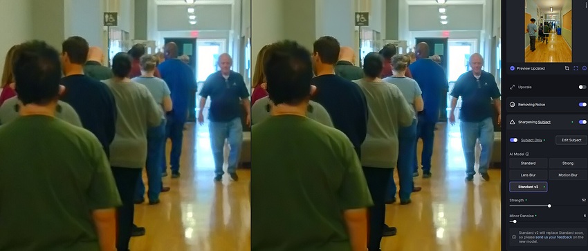

I ran a smartphone photo I shot at my polling station this afternoon through Topaz Photo AI. It autoselected Sharpen V2 and Face Recovery filters. I’m not happy about the extra line around the man walking up the hall. For comparison, I changed the sharpening filter from V2 to Motion Blur. In my opinion, Motion Blur gave better results overall, though still didn’t do much for the backlit man walking up the hall. You can see screenshots I made of the results:
Standard V2:
Motion Blur:

You’re using an outdated version of Topaz Photo AI and I would say upgrade to Topaz Photo Studio but, that’s entirely up to you to decide.
Also, you can either update to a newer version of Topaz Photo AI because, it has a few more new models to choose from Lens Blur V2, Natural and Refocus if you have access to one or continue as you have been using one of the other Enhancements Motion Blur or Lens Blur.
Besides, this behaviour should be expected given the poor quality of the original image
