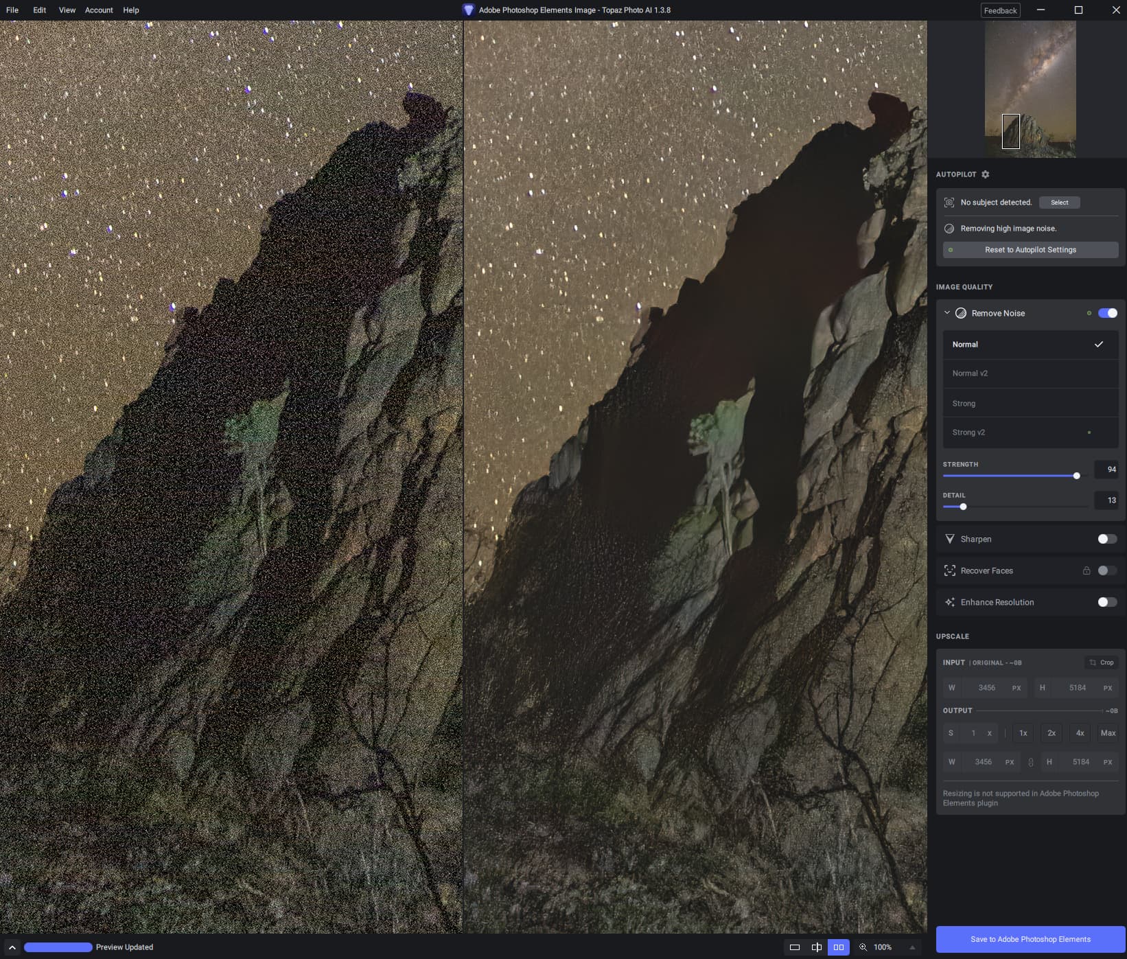

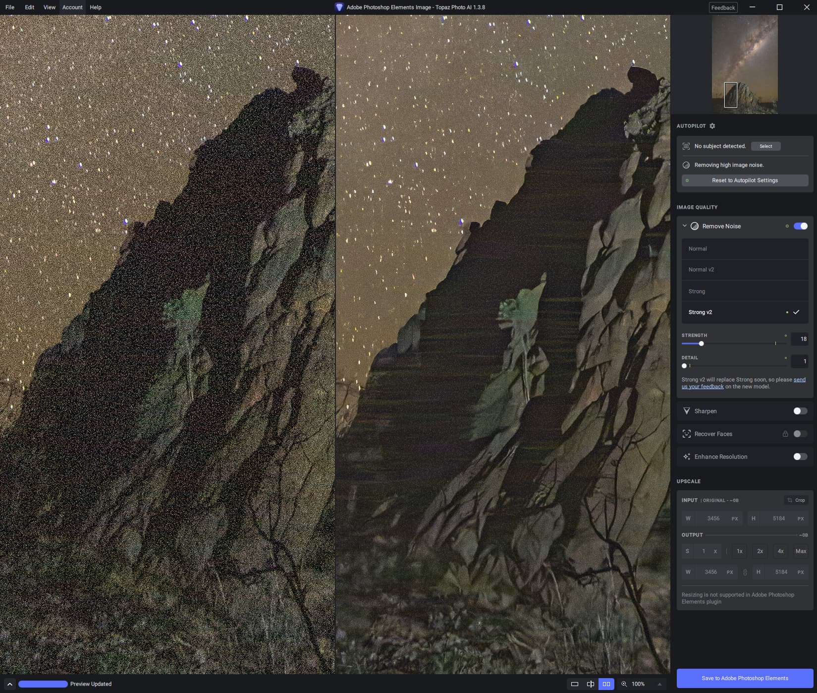

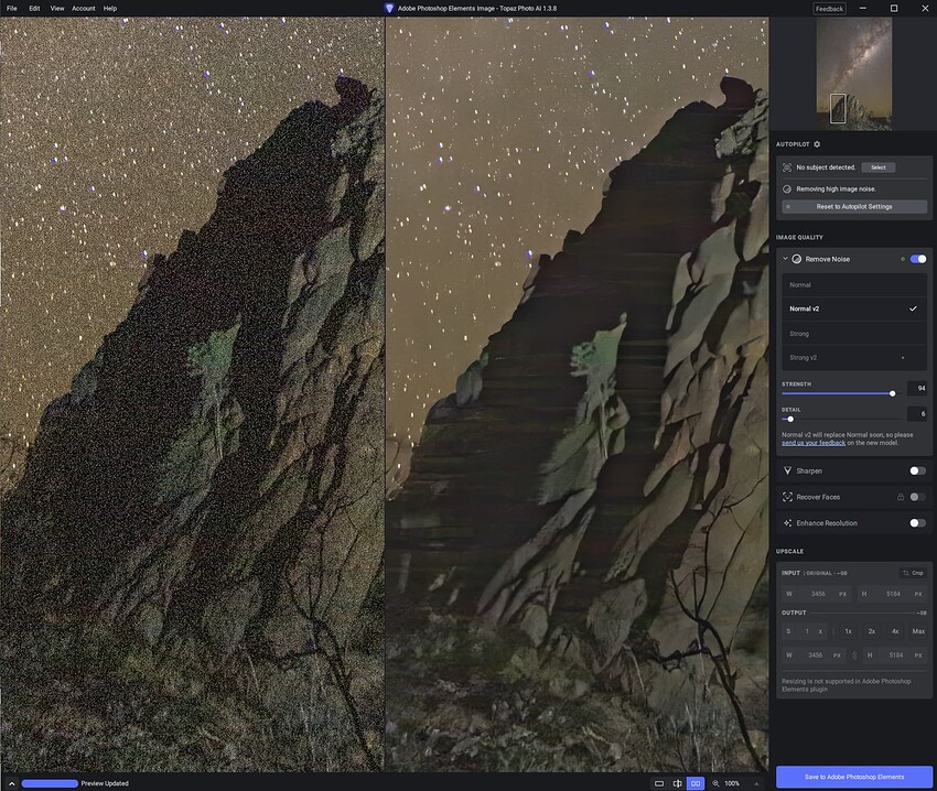

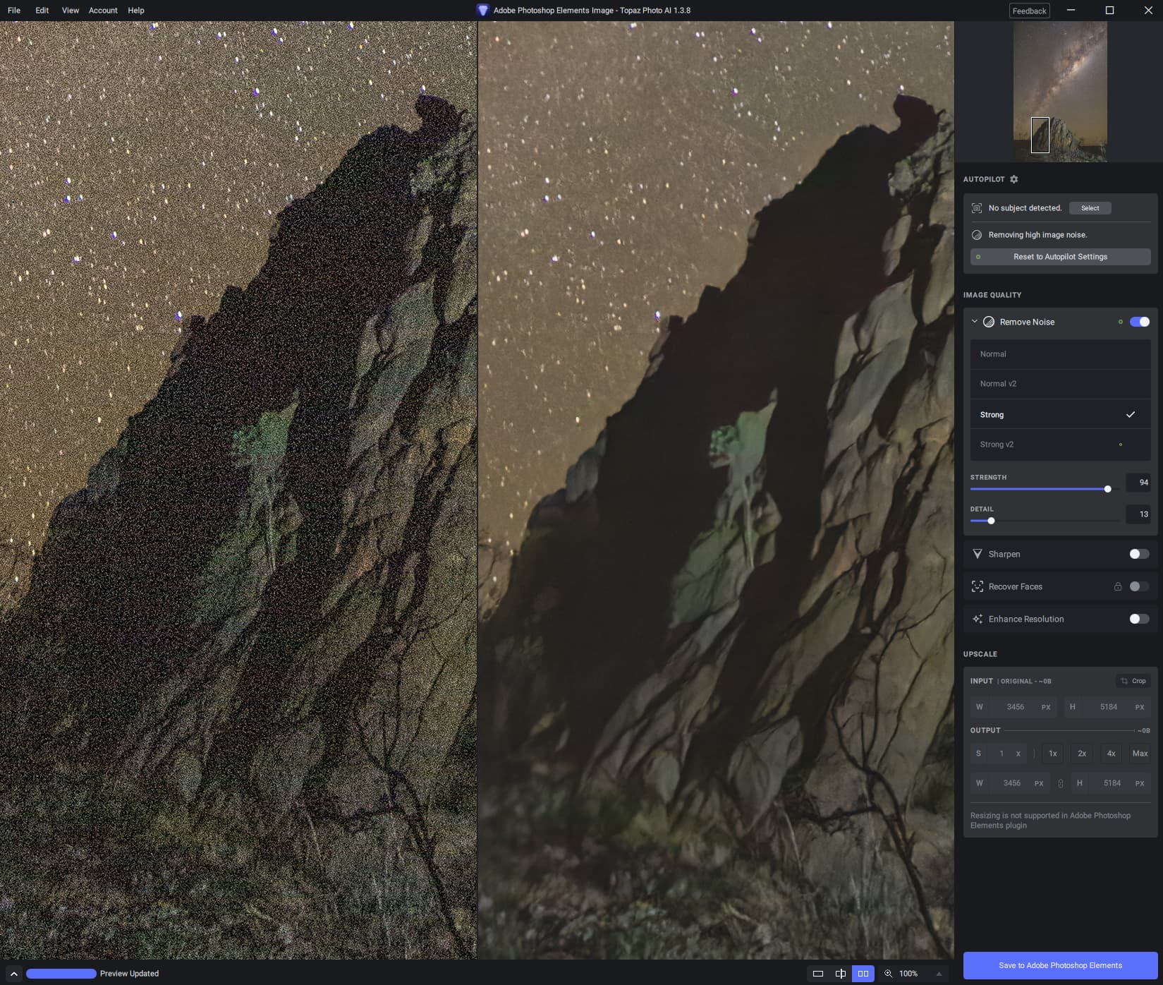

I’ve loved what PhotoAI can do to my noisy images. However, both of the “v2” versions smear my foreground elements in shadow areas on my attached examples. The original versions (both Normal and Strong) do not. Moving the sliders around had a negligible impact on the smearing. I do prefer the star field results with the beta versions.
Normal
Normal v2

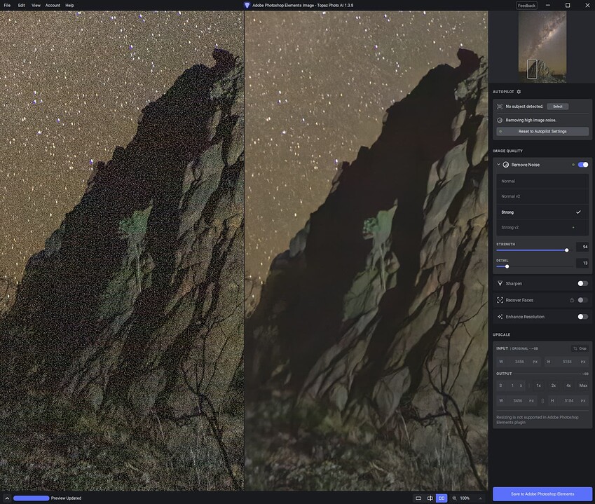

Strong
Strong v2

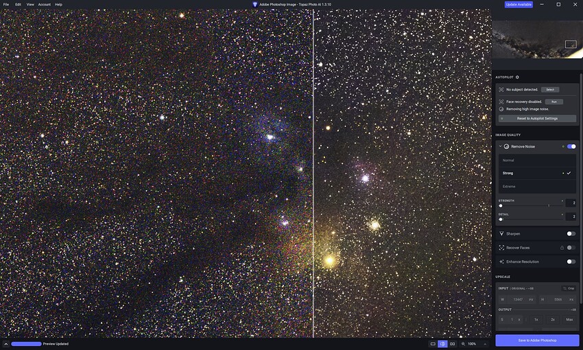

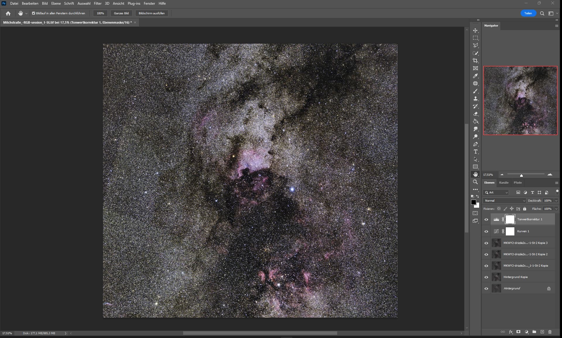

By pre-denoising you have sacrificed the colors of the Milky Way (you have denoised the colors before, looks like Lightroom or the technique of adobe).
Astro images are not completely uncritical.
TPAI manages to de-noise the image, with Model Strong V2 if you set it to very low values (applies to both new models), if you don’t do a pre-denoise.
My image is a 20 minute exposure (10x 2 min) at ISO 800 with a startracker.
( Skywatcher - Star Adventurer 2i Wi-Fi Photo)

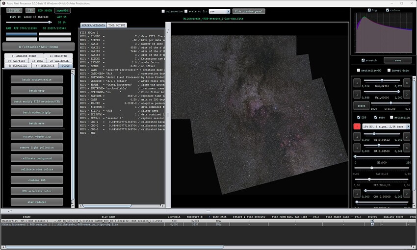

The image was stacked with Astro Pixel Processor, it is a mosaic of 3 shots taken with an EOS R3 and the Sigma 105mm 1.4 ART at f/4.
I refined the image with DxO Nik Collection 6 (Color Efex 6, Pro Contrast filter).
If you want to have the floor in the image, no problem, make a 20 minute exposure for it and stack it with Affinity or Siril and then mask it in, I haven’t tested the stacking for the floor with APP yet.
APP is able to remove light pollution to some degree.
I denoised it with TPAI enhance standard (2x enlarge) because it doesn’t change the shape of the stars, keeps the colors well and the sharpness increases when you reduce the image back to the original size.
I’m still in the research process with Astro images.
Procedure: Stack with APP (see below) → cut & rotate with ACR → enlage with TPAI (enhance standard) → PS (editing).
Astro Pixel Processor (APP)

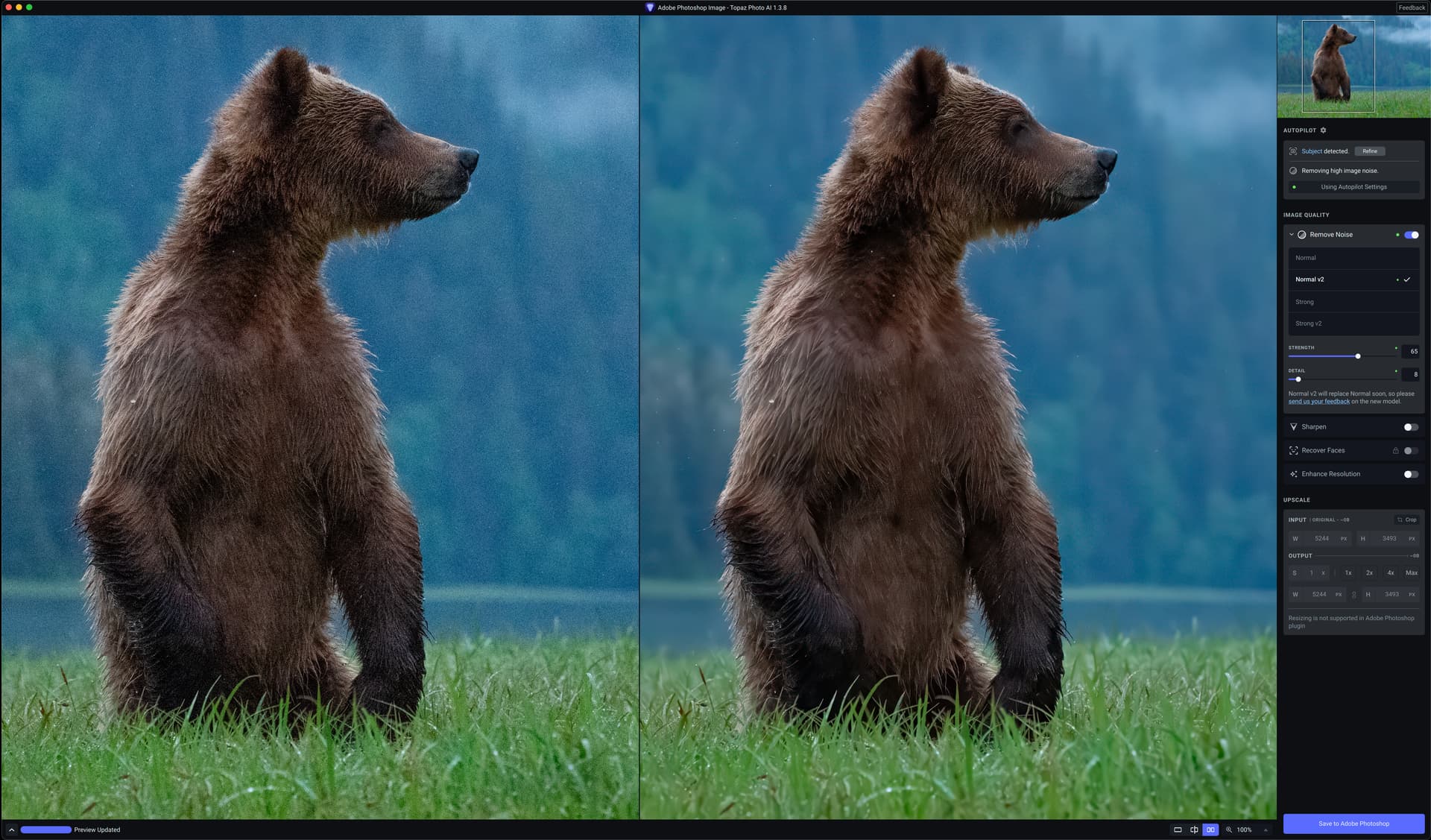

I feel like V2 still needs work before it’s the only version. I’m having to build 2 layers and composite them afterwards. The normal setting works nicely for fur, but the Normal V2 creates artifacts in certain areas of fur making it look fake and air brushed.

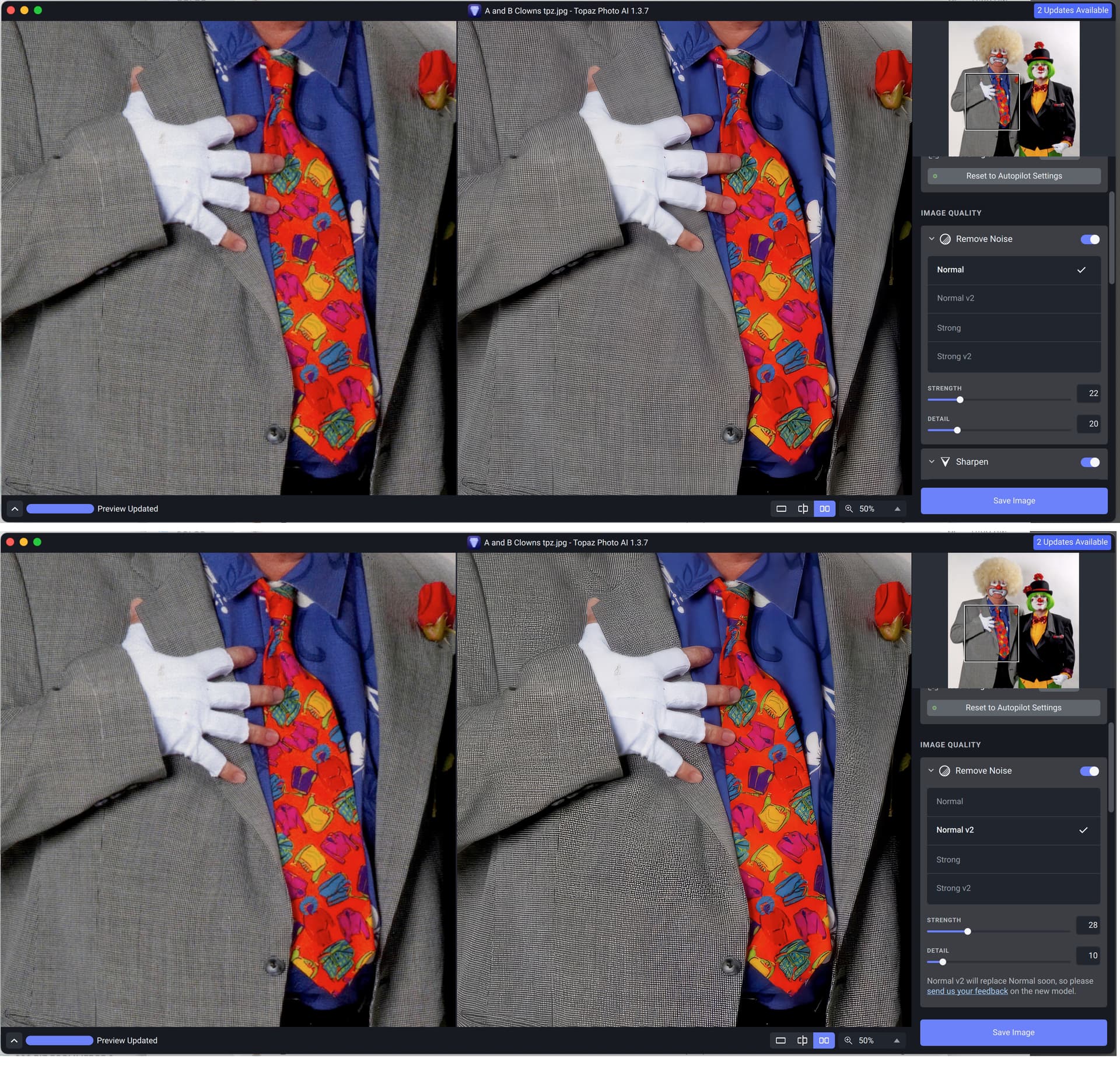

In this case I prefer original denoise. V2 destroyed the pattern in the jacket in this test.

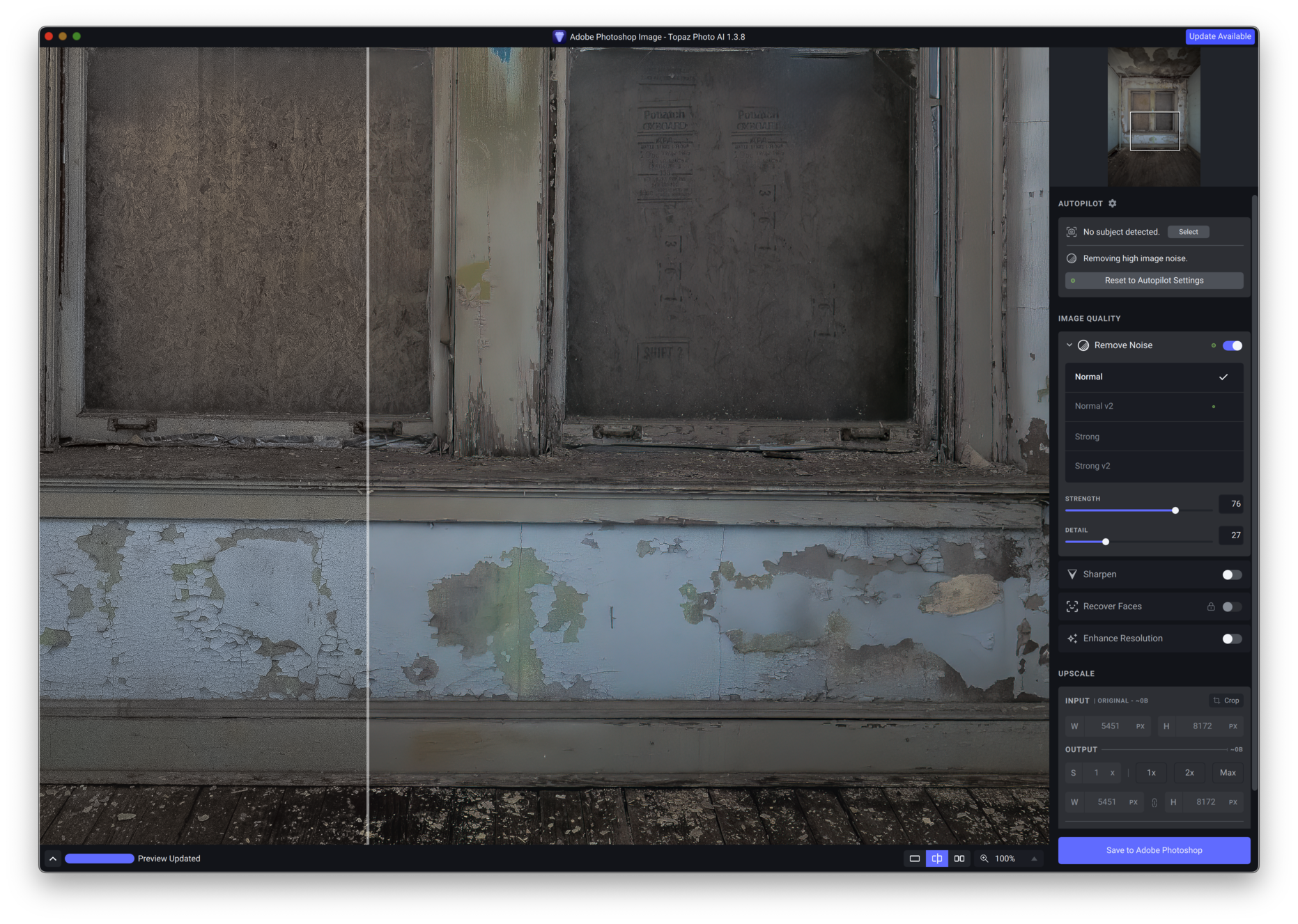

My issue is the new v2 is destroying detail and texture that no matter what setting I choose it cannot be fixed so I guess the previous was my last update
Check out the lack of detail in the windows

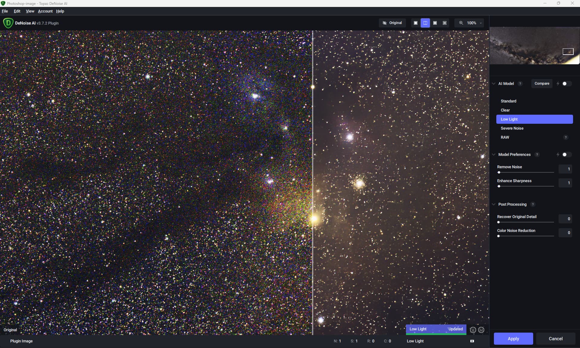

LowLight does smear details away, Strong V2 does not.
But Spaceclouds are clouds and not detail, but you can stack those filters and get the best out of it.

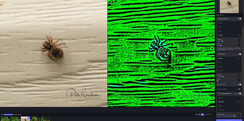

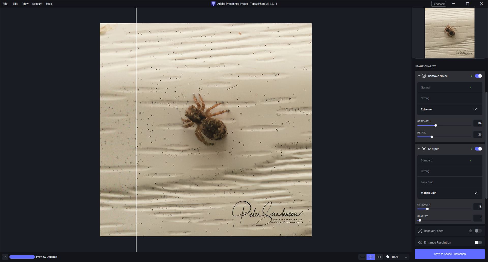

I had this issue with strong V2?
Peter - Not that I can do anything about it, but was that repeatable? What file format is the original (just curious)? Does it do it with ‘Enhance Res’ switch off (again, just curious)?
Also - Which release of Photo AI (PAI) are you using & got that result with? You didn’t include it in the snip (I don’t think…).
Here’s what I got with Rel. 1.3.11 of Photo AI - trying the different Denoise model options in the current release - you can see which denoise model I used in my filenames or by expanding the snips and looking in the righthand Settings panel. Have you tried your entomology images with the current release of Photo AI?
I used Motion Blur for the Sharpen setting. And I didn’t turn on Enhance Res (b/c I typically don’t like what it does to my images…). BTW, I also did not adjust Brightness in any way - the diffs. in the images are what appears in PAI.
There are three updates available so I am updating. I had shut down and then re-opened and it was not repeatable.
