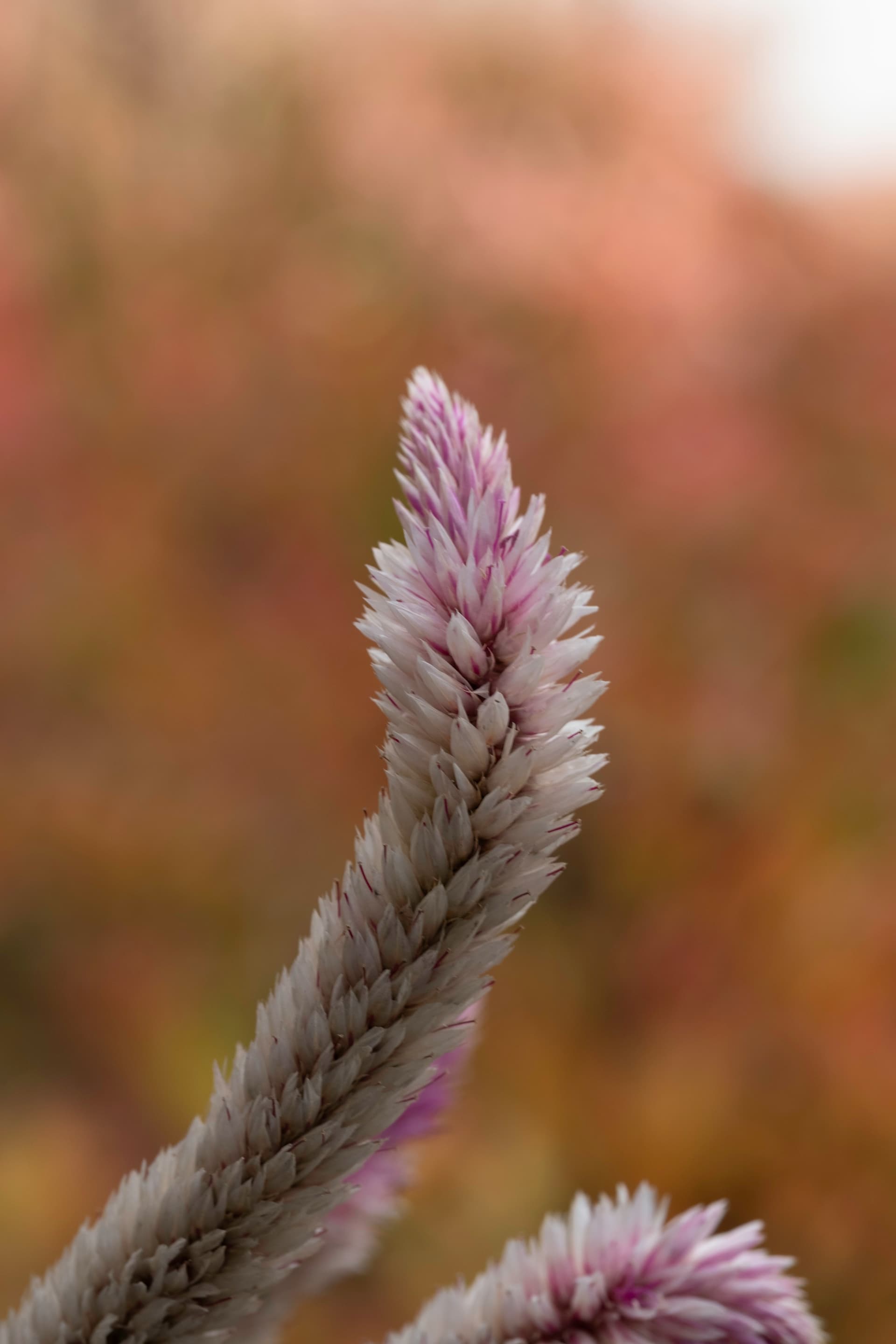

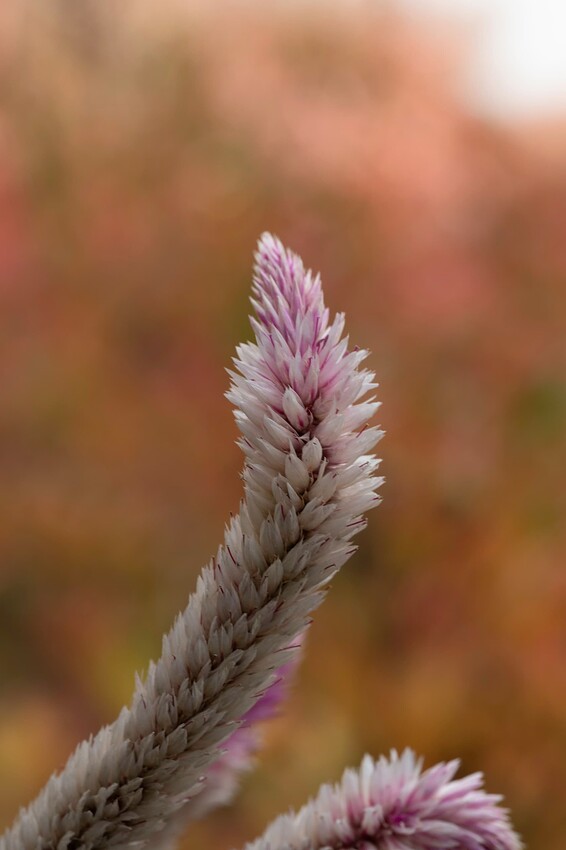

Hi Ange,
I have reduced the size and converted to JPEG from TIFF; the difference is not great, but there is a definite color change. As I finish up in Photoshop it’s easy enough to correct.

Yes, we would need the workflow details and also, the original added here! Keep in mind the original is not a missed focus case and not a case for Super Focus. Make sure if you want to force the enhancement on this file that does not need it (it makes it look unnatural) to put the Selection to Subject. There is nothing to refocus on the background and it will create artifacts. I would only use Sharpen Subject here, not Super Focus. Let us know how this goes!
Greetings and thanks for your responses. The workflow for these images has been rather straightforward with each only using Photo (Studio); for the before image, I did just a sharpen, so that I could export it as a TIFF; with the after image, I did just the Super Focus v2 (subject only), and then exported the TIFF.

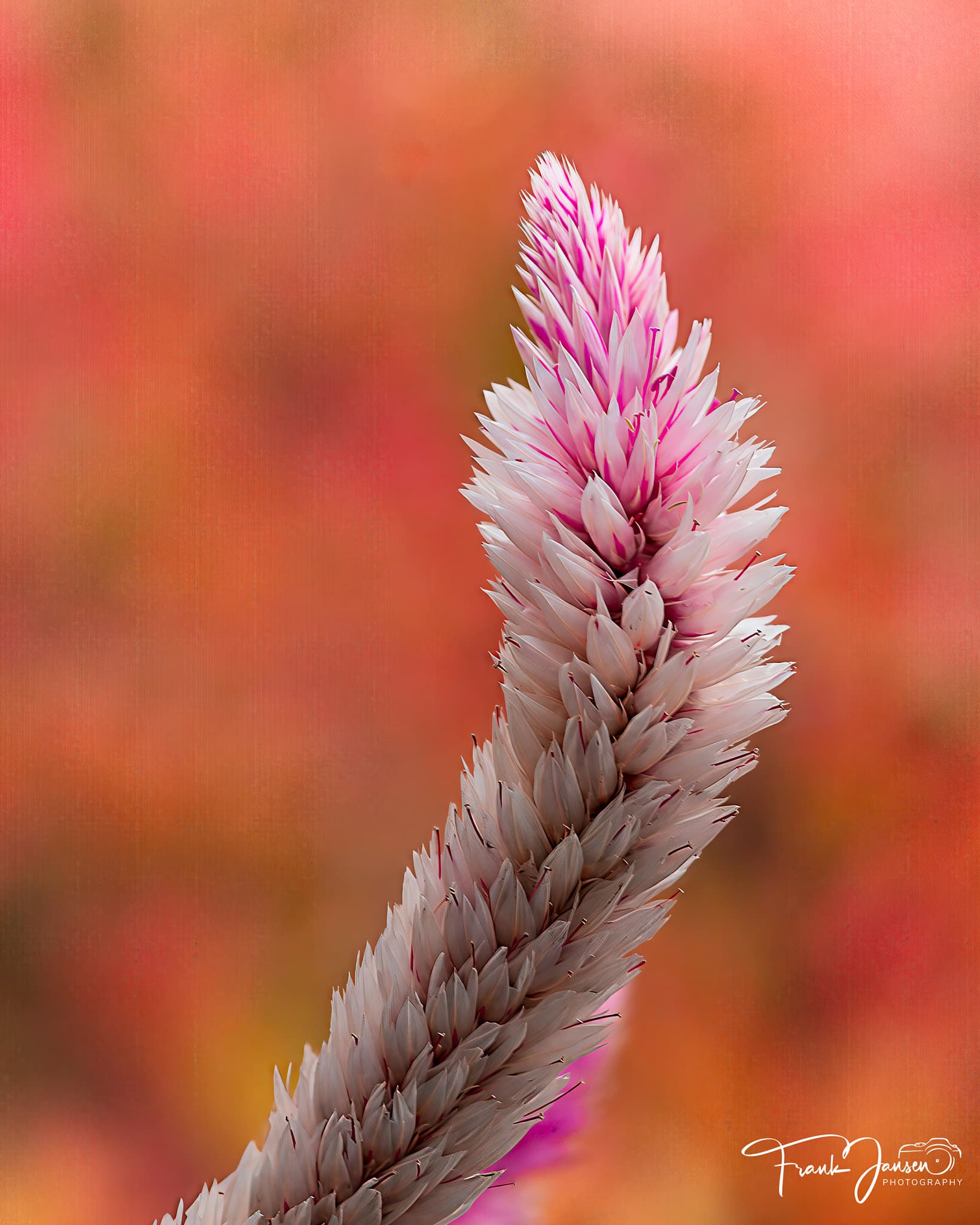

Neither of these were edited in Photoshop. As my usual Photoshop workflow will vary depending on the end state that I want to achieve, it probably won’t help much in this case. It tends to involve a number of steps, including the use of an ACR filter, possibly a Soft Light layer with minimal opacity, Hue/Saturation adjustment, Brightness/Contrast, and quite often a low opacity Black/White adjustment.
I have attached a final version with my adjustments to give you a sense of what I wanted to create from this image.

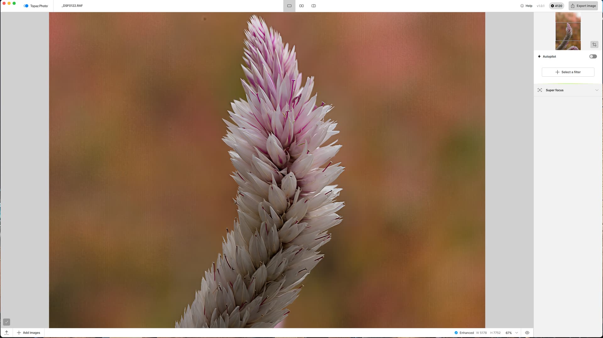

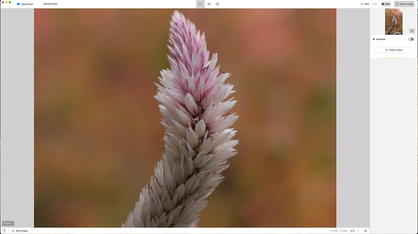

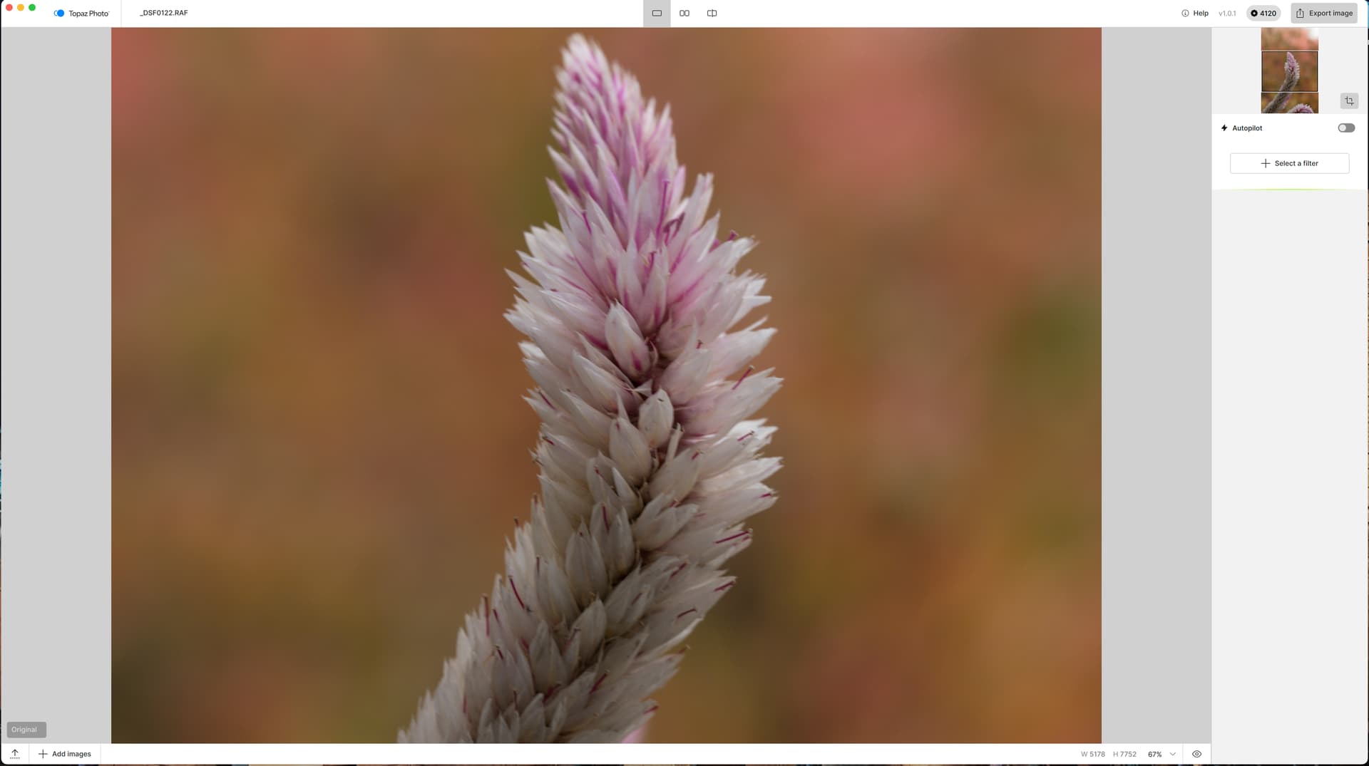

When you send your email with the RAW file - if you can show the in app RAW you see and color loss you get (screenshots) and we can test too see if can replicate!
Hi Ange,
Apologies for the delay. I have sent the raw camera file to the support email address and here are the screenshots of the before and after of Super Focus. Screenshot-DSF0122-Topaz-Photo-1 is the before and Screenshot-DSF0122-Topaz-Photo-2 is the after.
Thank you!
Frank
Thanks! We see in the original there is already a grid pattern in the background. It will be important to not put any sharpening or focus enhancement on the backgrouond. There is also no missed focus here and Super Focus is not the tool to use for this.
  • For Best results: Use Sharpen and make sure Selection is on Subject only.
  • If you really want to use Super Focus (not recommended, gives un natural over processed results) - it would be important to remove the background from the selection, by clicking on Super Focus, and using the Selection options to choose Subject.
