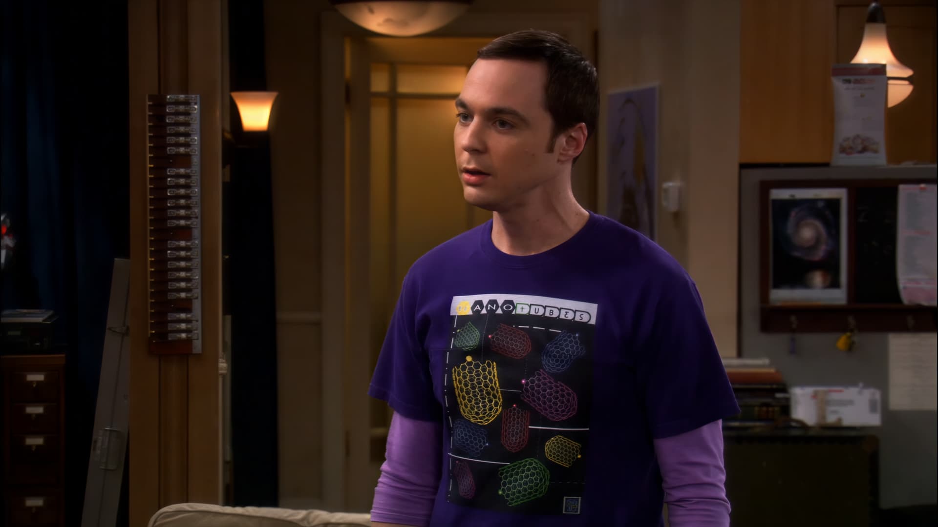

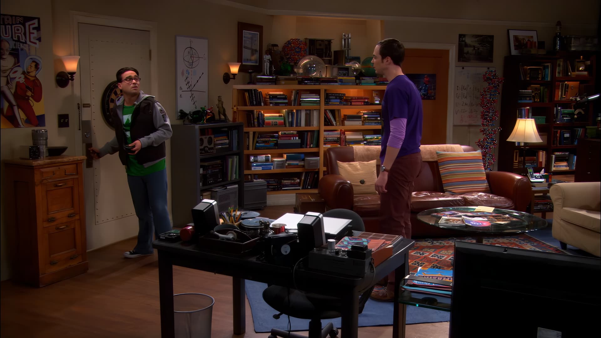

The following is the original snippet from both wide and close shot

Close shot
  1. it is more intensive and truth be told is amazing with figuring out details in the background, if you look in the back left side the building intercom panel (I was also confused why it’s in living room filming set but anyways) is way more visible than all the other modules, none of them were able to enhance it.
    In addition looking at the face it did a great job enhancing/sharpening without loss of details

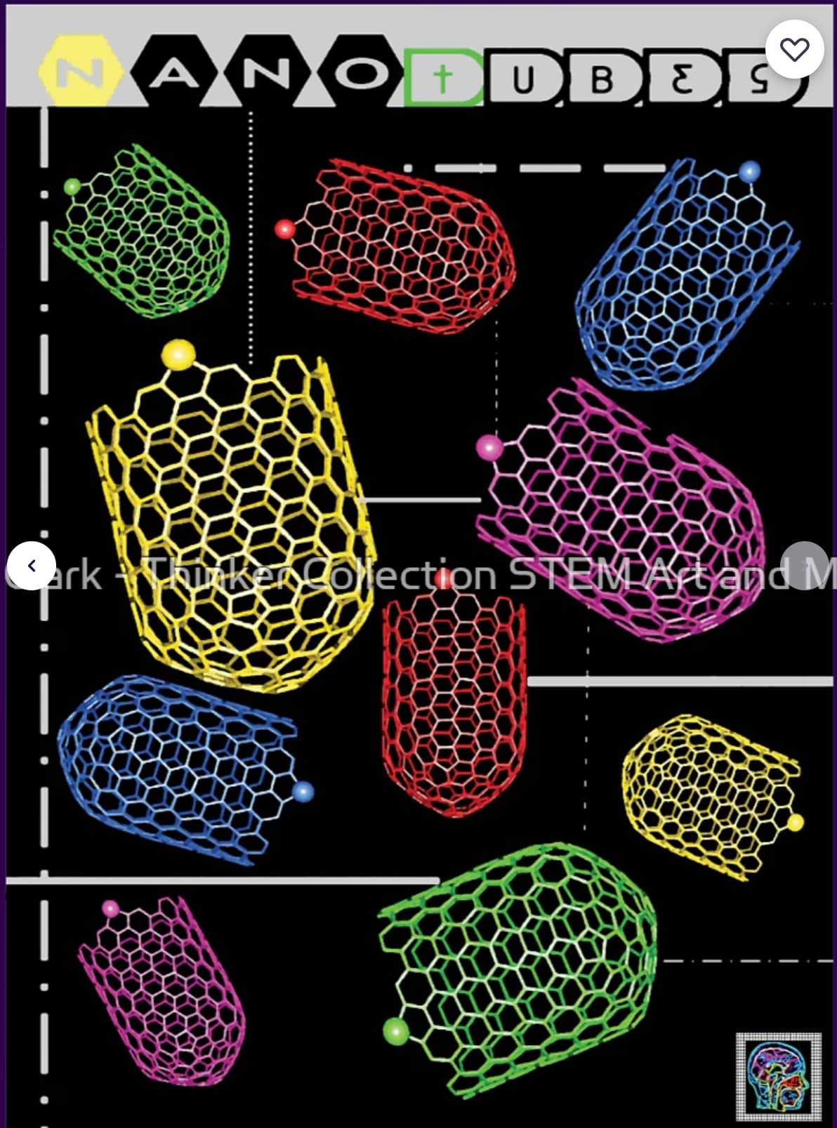

  2. The text on the shirt is clearer and sharpened, you can clearly read it, the Nano tubes are detailed and you can se the enhancement catching the less visible lines in the back and catching it, and finally the very tiny head at the bottom left of the shirt was captured although wasn’t enhanced properly to what this original shirt picture shows it still managed to grab as much details as possible.
9/10 for close shots
Wide shot
  1. Smoothens everything out, enhancing the quality especially on the big text such as the whiteboards texts, the text is much more clearer now and readable
  2. doesn’t try to enhance text on smaller objects such as the textbook on the bookshelf
  3. great with face enhancement and again doesn’t try to overdo it
10/10 for wide shots

Close shot
  1. right from the start you can tell the face is “sharper” with more details in the hair however the eyes suffer a bit, loss of improvement for the background buzzer item,
  2. the text on the shirt is sharper however!, AI is heavily more used here and some changes are done to the letters, the N is more rounded and the S turned into a 5, but more importantly the nano tubes were over sharpened that they lose their 3Dness not to mention the brain figure at the bottom left became a mosh.
7.5/10

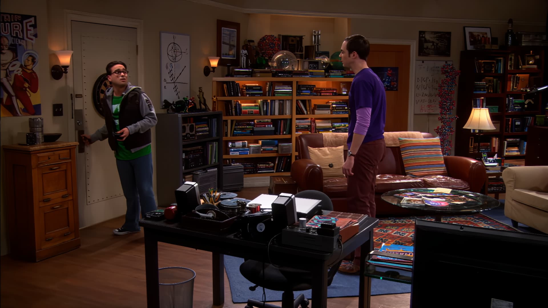

wide shot
the wide shot on the other hand is a mess.
  1. the whiteboards are blurry now and lines + text is woven together.
  2. Text on books completely wiped out and feels off
  3. face enhancement failed for further away, I see features but worse than other modules.
3/10
