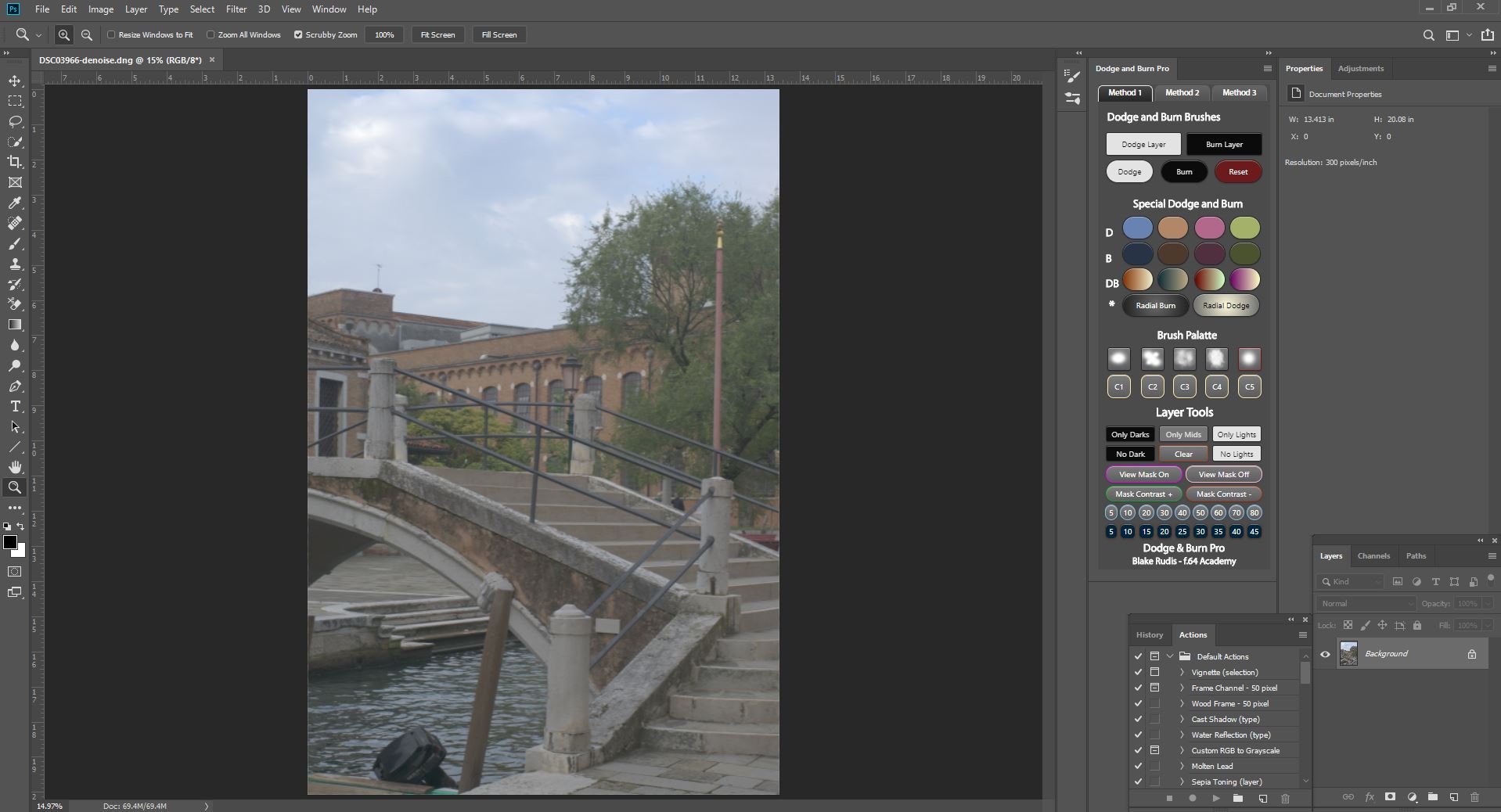

Every image I process with the latest Denoise AI 2.0 produces a weird color shift and total loss of contrast. The image shown here is typical, and looks like this as soon as I open it in the application. What’s wrong?

Yes, it is a RAW file opened directly in Denoise with no corrections at all.
I first tested by exporting original (RAW) files out of lightroom and opening in Denoise AI 2.0. Found I have the same issue. The color profile appears to be stripped out and the change is visible upon opening the file in Denoise AI. These were RAW files with sidecar XMP files.
I tested a bunch of variables for the export format (RAW, DNG, TIFF, JPG) from lightroom and found I could retain proper color if I opened a TIFF or JPG in Denoise AI 2.0. The “save as” format didn’t seem to matter. So until they get this straightened out I am opening TIFFS in Denoise AI 2.0.

Hi Artisan-West, I realize he didn’t mention he was using RAW images, but since it was exactly the same symptoms I was getting when using DeNoise I figured it was a pretty good chance he was. I’ve posted a step by step procedure I use for my temporary fix. It was Adam, one of the developers I think, who gave me this advice. So I didn’t come up with it on my own. I’m not that brilliant.
Here is a step by step procedure I’m temporarily using until Topaz updates the color libraries.
Here is my original ARW (RAW) image. Be sure to click on the images first to see the entire image.
Here is how it turns out after processing through DeNoise.
Here is the Adjustment window which you need to open up. If you don’t see it go to the Photoshop Window drop down column at the top left of your Photoshop window.
Now click on the curves adjustment.
Now play with the curve to make the image the way you want it to be.
