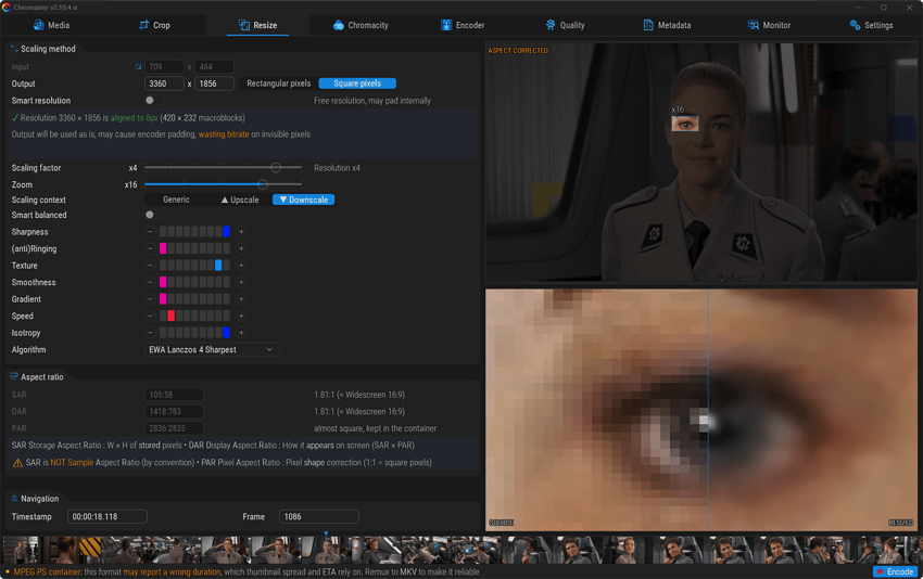

Chromaster v2.10.4 α
It wasn’t easy to design, but I hope I’ve included these features with the usual comfort and ergonomics
FFmpeg’s “Starship Troopers” sample test file
:television: Anamorphic sources, handled properly :television:
Aspect ratio
  • :triangular_ruler: Non-square pixels now survive every codec :triangular_ruler:
    AV1, AV2 and NVENC dropped the aspect on the way out. A 16:9 PAL DVD came out squeezed on AV1, correct on ProRes, same settings. Now written at mux time.
  • :eye: The GUI shows the corrected image :eye:
    Every preview, thumbnail and comparison displayed stored pixels. An anamorphic source looked wrong inside Chromaster before you even encoded it.

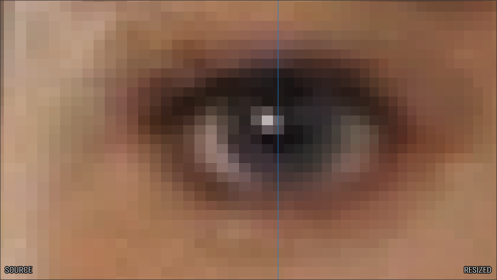

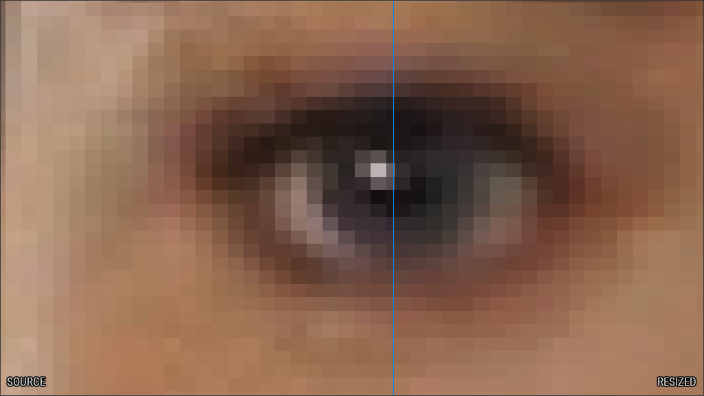

  • :white_large_square: Rectangular / square pixel switch :white_large_square:
    Pick what the file actually contains. Rectangular keeps the source dimensions with the aspect written alongside; square really widens the image and needs no aspect at all. Widens, never shrinks, and the scaling factor then works from that new size.
Rectangle px preserved Rectangle px squared

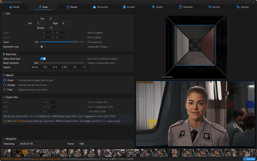

  • :bullseye: Crop presets mean what they say :bullseye:
    The 16:9 button targeted 16:9 of stored pixels. On an anamorphic DVD that produced a 2.5:1 image. It now targets what you see.
