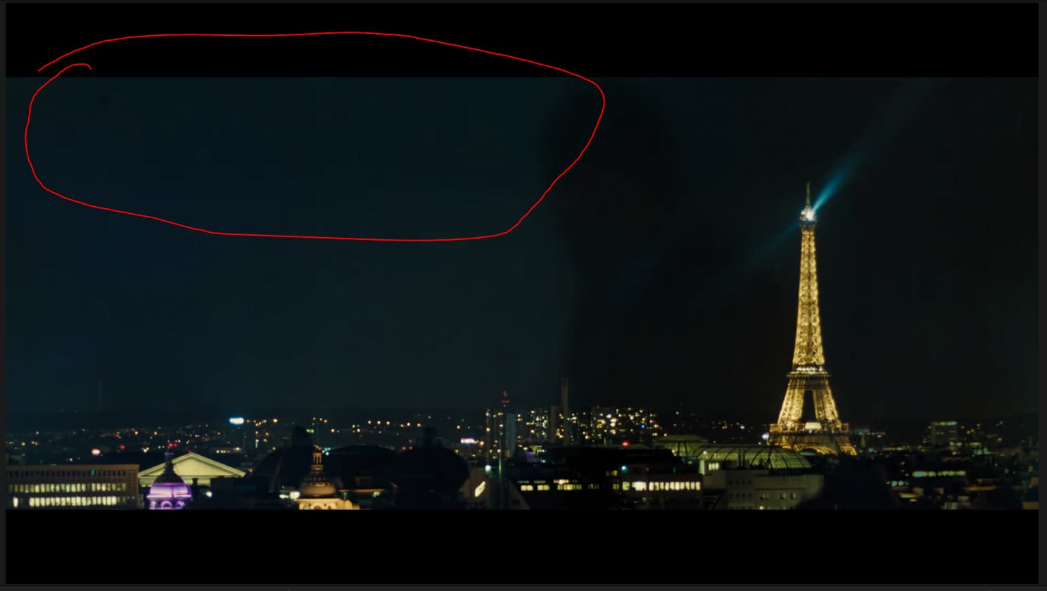

Im Editing old movies with Topaz Video AI Using Artemis Medium model as it is fairly quick for my RTX3070. (about 3-5 hours per 2h movie). Im happy with it BUT on dark scenes it destroys backgrounds! It turn them to huge pixelblocks.
Same begavior on v5 v6 and v7
I use Medium setting with add noise 2 and Recover detail 30 Nothing else is applied.
Maybe someone can give recmmendations how to solve this?

So OK, i found a solution after many days of experiments -
First of all - use 5.3.3 version - everythin newer - ruins image so badly! Look like algo is so broken after this version. (i mean that v5 pixelates aswell but newer version compared to v5 are much worse!)
And lastly main point of solution - export should be done in TIFF images rather then as a video. Topaz codes video SO BADLY. After I take TIFFS and turn them back to video with Resolve. Now i get super crisp and absolutely no pixelasation!
