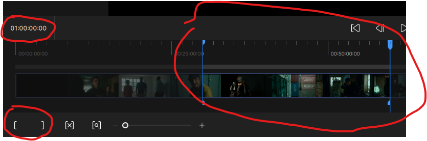

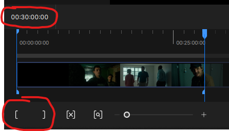

It’s actually more convenient not to render the entire file at once; divide it into segments. I shared information about this two days ago; it’s the most logical approach. This way, even if there are errors, you won’t waste too much time. For example, I divide videos into 3-minute segments and then combine them. I can also pause the process whenever I want. I’ve even written small Python applications for this. But you should start the segmenting process in Topaz Video; it will be easier, and then combine them in the video editor.

I told you the easiest method, but you haven’t even tried it. You’re looking for something more difficult. If you use other methods for segmentation, you need the best quality segmenter, otherwise the quality will drop. That’s why I told you the easiest way: rendering by segmenting. Then the quality remains the same.

From a purely practical point of view, I don’t see segmenting in TOPAZ itself as the easiest way, because it’s a pain to set the in and out points exactly in this timeline.
So I set an out point somewhere, and it’s not saved anywhere for me when I want to do the next segment at some point. So I have to search for it laboriously and set it as a new in point.
