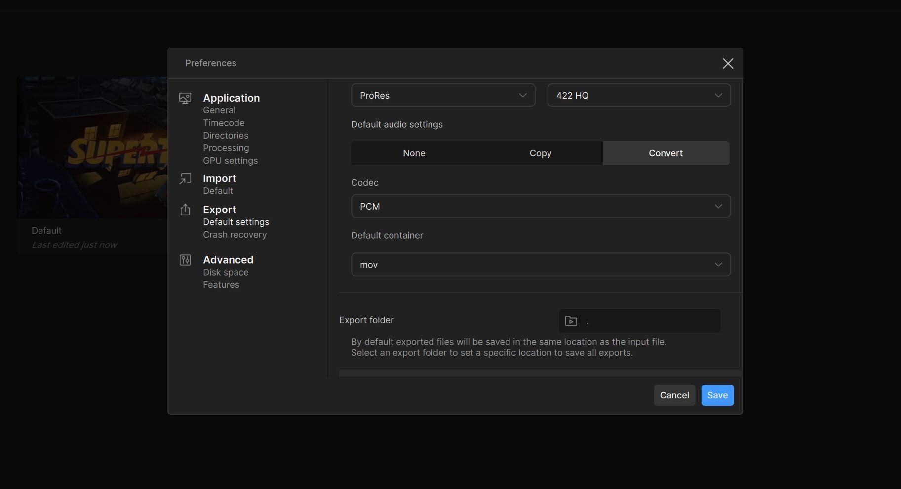

I got audio as I just did a small ProResHQ export test. Have you tried using Audio Convert?
Edit: I now see that you tried to convert to AAC with no luck. Maybe Topaz just will not do 24-bit audio? Hmmm…
Nah. Tested with a short video clip with 48kHz 24-bit audio here, and it worked just fine, both with copying and converting. The little clip was also rendered out in Resolve Studio 20.2.2. So not sure what it could be… Are you also on Windows? 10 here.
