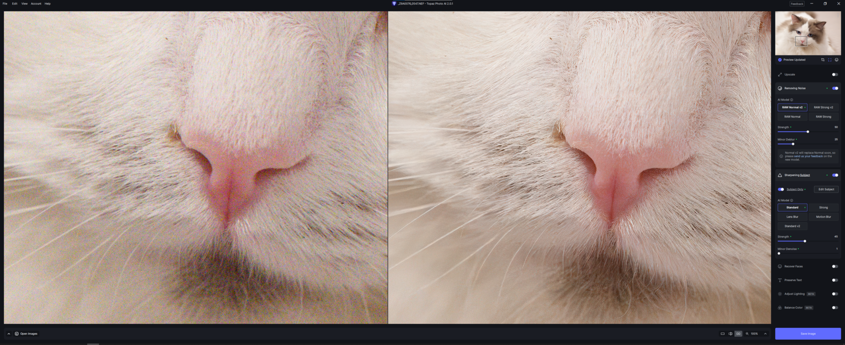

Using Photo AI V2.01, I am still getting artifacts. I have got them before on Photo AI or Sharpen over the past years and had hoped V2 would get rid of them. I processed an NEF file using auto pilot and made no adjustments and saved the file. Then I processed again and reduced the amount of sharpening by about 1/4. Still artifacts. Look to the right and left of the cat’s nose. How dp I get rid of these

I have sent to you via dropbox the original NEF and processed DNG files.
Attached is the screenshot.
I get this problem less with V2 and V2.01, but as you can see still sometimes.
Any help you have is appreciated.

Thank you for following up. I was able to get the artifacts next to the nose when using the Sharpen - Standard model.
However, switching to the Standard v2 model seems to prevent this behavior. Does using the Standard v2 model work for you or are you seeing a different artifact than the one I am pointing out?
The Standard v2 model will be replacing the Standard v1 model soon.
