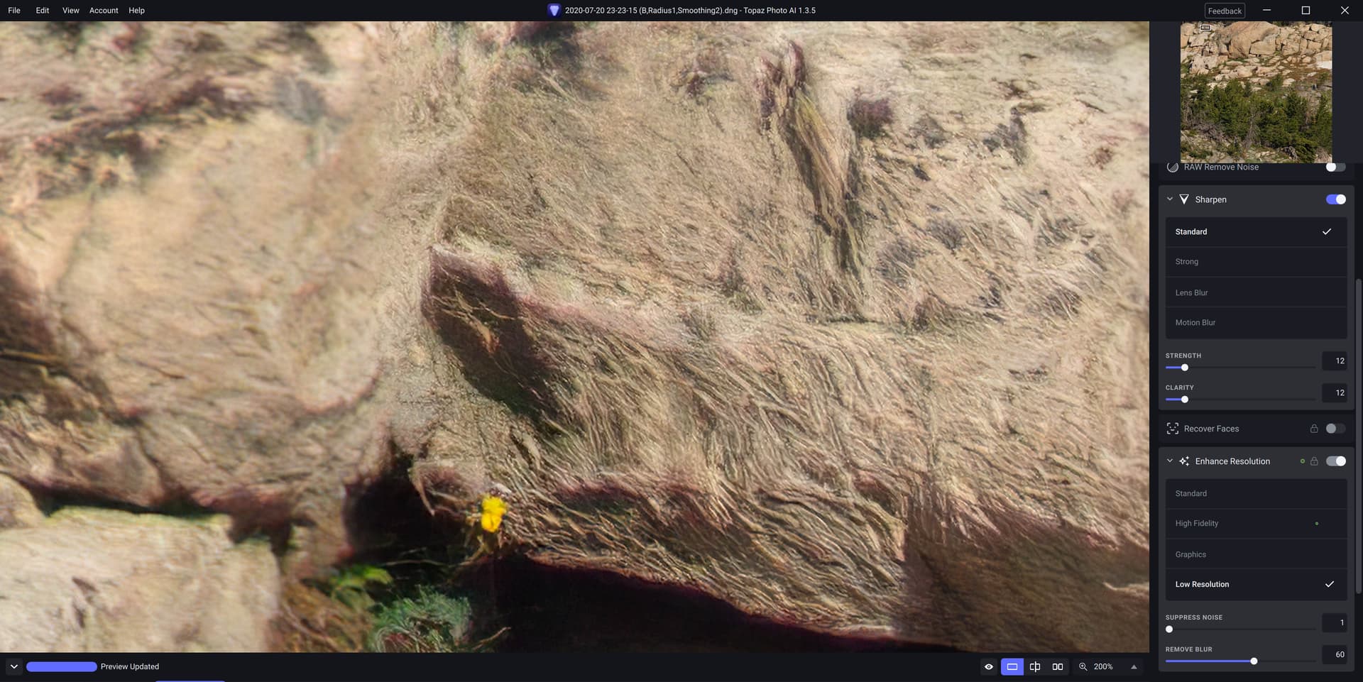

Biological rocks with a giant helping of blur on the left.

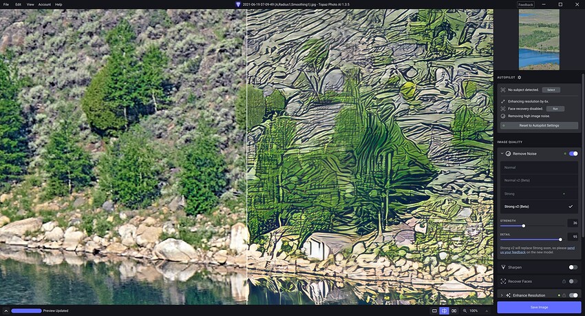

Here I was using raw remove noise and instead of that, I get paint dab art, even when I lower the strength way down.
Here’s an example of wavy lines. I turned the remove blur slider all the way up to really show the effect, but it still does it even at 50% and less, just not as extreme.
With the exact same setting, Giga did not do this hardly at all on the bush, but nearby rock, it did the lines pretty bad, but only took one second to render the scene when panning.
@devenpsc Thanks for uploading the screenshots and the descriptions.
Please send me your system profile information so I can check if your computer hardware is up to date.
How To Obtain Your System Profile (Windows)
I would like to try to reproduce these problems on my end. You can securely send me the following original image files using my Dropbox link below.
Submit to Dropbox.
