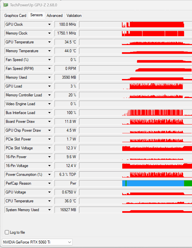

What are you using to view the GPU usage on your system when running a video through with Aion?
The task manager can be incorrect when showing actual usage, we recommend using GPU-Zif you are not already. I just ran a quick test in v1.0.4 and here are the results with a 5060Ti.
I was using task manager. I will try that
Gpu z was tested and the card goes from 6 percent usage to 93 percent fluncuating wildly and rapidly. Wattage and usage flunctuating.
Other models like chronos fast just stay at 98 percent usage. You can see in your picture only 3 percent gpu load.
That’s what I mean when I said it doesn’t really use the gpu totally. Is there a reason for this Kyle? Thanks.
Fluctuating results can be expected as the model processes frames of the video.
In my reference image, the process had completed by the time I grabbed that screenshot, but the red usage before that was the model running on a video file.
