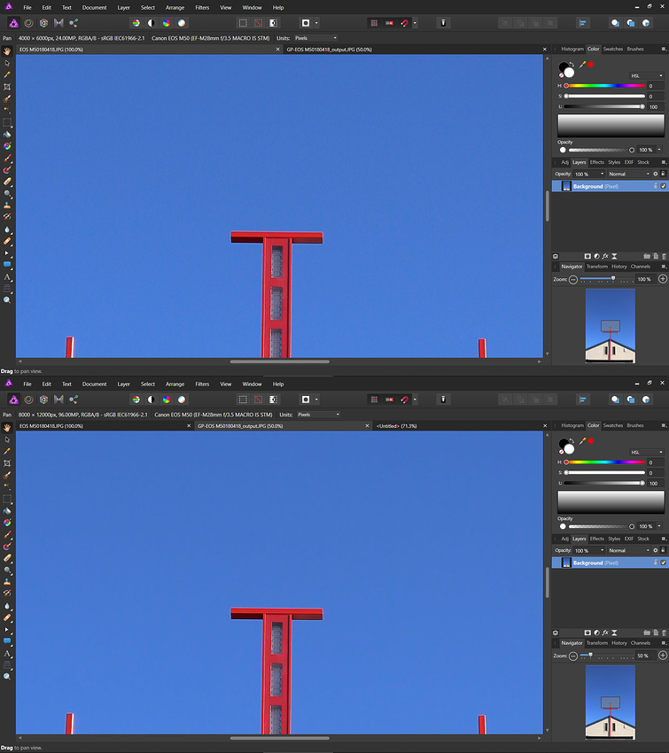

Hi guys, the reason I am asking for all relevant information is I am net seeing what you guys are seeing. Try to do the following:
- Specify the original documents ICC profile
- Upload a screen shot of the parameters you are using
- Then a screen comparison of the Original at 100% and the resulting at a relevant zoom, i.e. if you do a 200% upsize the result can be shown at 50% as you see here with the original on top, result on the bottom.
So, here this upsize is done on Windows 10 using a NVIDIA GTX 1050 GPU (4GB) and driver version 398.82 where the input was sRGB/JPEG and output 200% upsize with no conversion … Original TOP, Result BOTTOM:
