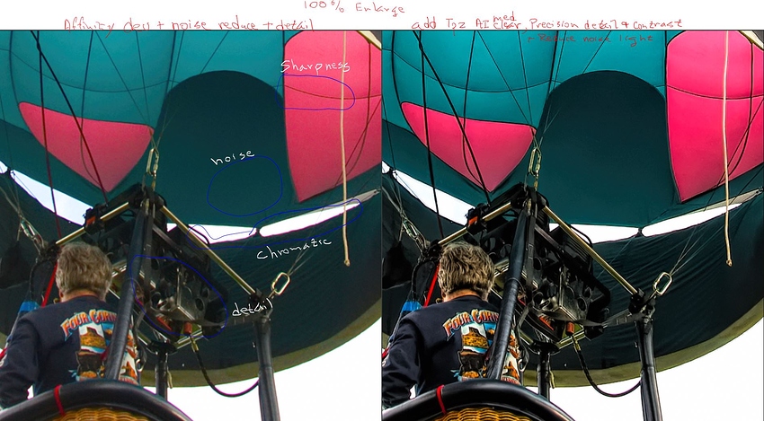

AI Clear may not solve every problem and I have used Reduce Noise after it on some pictures but it also shines in other areas such as sharpness, pulling out detail (even from dark areas) and reducing or eliminating chromatic aberrations. Here are two comparisons. In the balloon image, I first processed in Affinity (similar to Photoshop) and then processed (in addition) in Studio using AI Clear and lightly with Precision Detail, Contrast and Reduce Noise (I know they tell you not to pre-process the image but it still works if not overdone). I have circled example areas in blue.

Both original files were Sony camera raw.
AI Clear did a very nice job on those images. One thing I did notice when I did my testing was that AI Clear performed very well as long as the image was not very, very noisy. In cases with lower ISO values it cleaned up the image and it sharpened a bit as well.
Where it failed badly was when images contained a lot of noise. Using my M43 camera any image shot at over perhaps ISO 3200 suffers badly when processed by AI Clear and images shot at the highest ISO (25,600) looked worse after processing than before, but lower ISO values yielded very nice results.
If they put AI Clear on sale I would probably buy it and use if for noisy images with lower ISO values, so I do like it, but would avoid using it on higher ISO value images.
