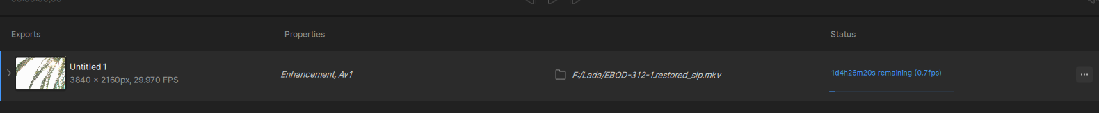

B. Who is going to believe this is only a 1080p to 4k on a RTX 5090:
I knew Topaz Video AI from way back like 5 years ago (yeah it was called AI Enhance or something) and now I wanted to come back for its new features. Only disappointment is now. So did the team run those Starlight Precise 2.5 benchmarks on RTX 8090???

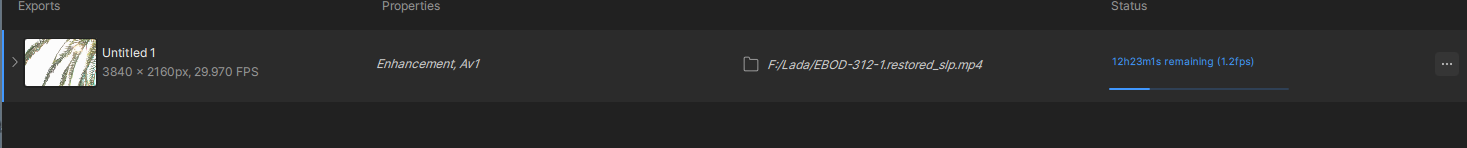

I will try mp4 as the output format instead of mkv.
It actually runs the same when the output is mp4:

Ahhh, actually, 0.5 to 0.9 frames per second on any Starlight process is about average (for a 5090).
Topaz changed the underlying architecture of the Starlight models in release 1.4. If you were around in Topaz Video Enhance AI days, when they switched to using FFmpeg and the AI processing as filters, you might remember a tough transition period. We are going through something similar now.
The last fully stable release was Topaz Video 1.3. Install that build and Starlight Mini, Sharp, Fast and HQ will all work correctly. You won’t have access to Starlight Precise, but Sharp, followed by a quick run through Proteus will get you quite close. Hopefully we will get a release 1.7 or 2.0 soon that will resolve the problems with the new architecture.

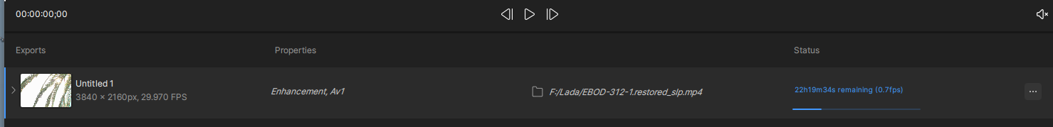

I only hope that my 5090 could render me at least 1 fps, like stably. That way, I could save at least 7-8 hours on this project.
Render times for all of the Starlight models (which are based upon a different kind of AI analysis than any of the other models) is most impacted by the size (resolution) of each frame, going in and out. For example, a 2X upscale of a 640x480 to 1280x960 will be faster than a 3X upscale to 1920x1440, both of which will be faster than 720x540 to 2880x2160.
Overall time is obviously also influenced by the frame rate of the original (i.e. a 24fps original will complete sooner than a 29.97fps source of the same runtime since there are fewer frames).
The average processing time for a 2X upscale from 720x540 to 1440x1080 at 29.97fps is about 41 hours on my PC (Intel i9 14900K CPU, RTX 5080, 64GB DDR5 system memory) using Starlight Sharp. I haven’t been able to run Precise on my main PC (same problem you have) but on an older machine (Intel i9 9900K CPU, RTX 5070Ti, 32GB DDR4 system memory) it runs about the same speed as Sharp does on that system. Typically, depending on the content being processed, I have seen 5090 users report anything from 0.5 to 0.9 fps. So far, I haven’t seen an actual report of reaching 1 fps on consumer GPUs. Perhaps a Blackwell RTX Pro 5000 (48GB VRAM) or RTX Pro 6000 (96GB VRAM) will get there, but all I have seen is conjecture since those cards are about $5,000 and $10,000 respectively.

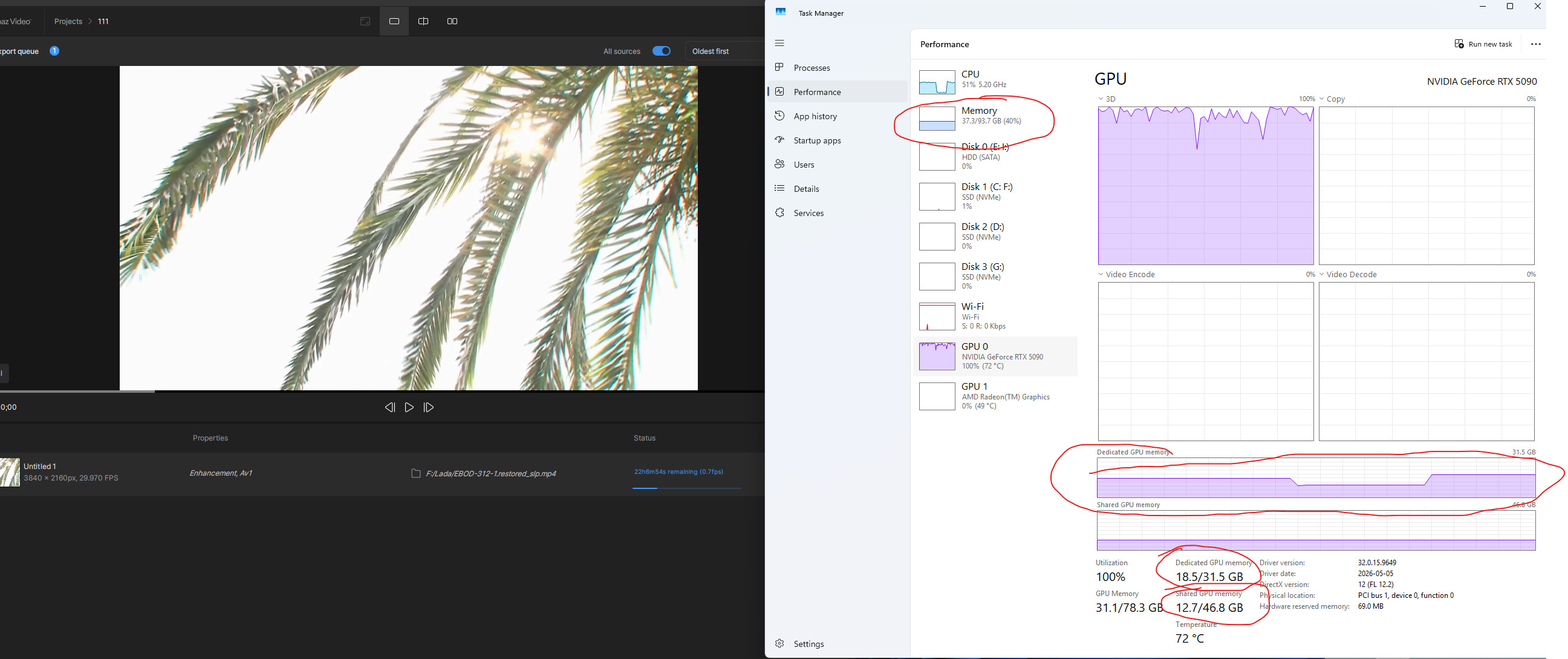

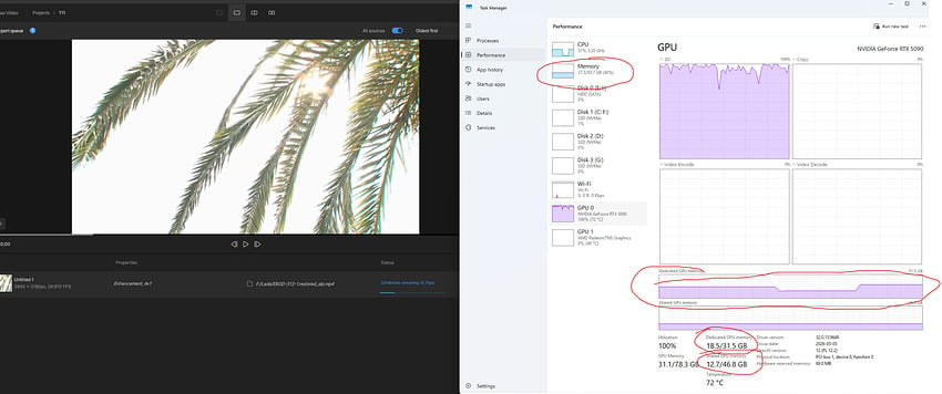

You know what? I don’t feel like it is a RAM or VRAM problem, but the graphic core hits the wall first:
Yes, in the final analysis, throwing more CUDA cores at the problem is the only thing that helps speed. More VRAM doesn’t make it noticeably faster, it just makes the output look better in the same amount of time (due to larger batches, and room for more overlap). But even there, the newer releases (1.4 and up) are not even using all of the available VRAM, basically capping everything at 5070 or 3080Ti quality level and higher spec GPUs offering only more CUDA cores. That is all the workstation cards offer - more cores than most of the consumer cards.
