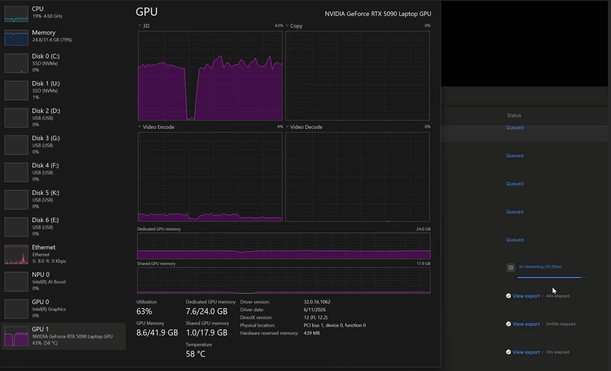

Screenshot β€” warm path = GPU working, not 3 min idle
What the capture shows on an RTX 5090 Laptop after package map is warm:
Signal Before fix (every new worker) After durable package map (same tile)
GPU 3D ~0–1% for ~3 minutes ~63% active (Apollo inference)
GPU temp / load Idle while CPU one-thread spins 58 Β°C, real work
Export UI Multi-minute β€œEstimating” / silence before frames Seconds remaining @ ~31 fps, jobs completing in ~20s–3 min of actual render
Queue N Γ— ~3 min prep + short GPU Prep amortized; queue is GPU-bound
Before: one CPU thread hot, GPU parked, log silence after CACHING MAY NOT WORK.
After: same Apollo tile β†’ map load ~0.25 s β†’ TRT hit β†’ GPU graph actually moves.
This is the user-visible proof the stall was package materialize, not β€œthe 50-series is broken.”
