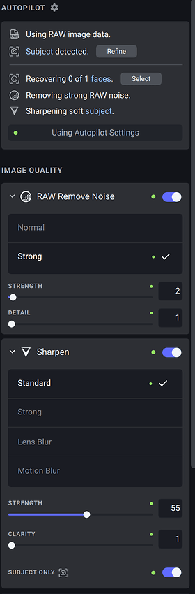

Using Lightroom Plugin Extras to launch Photo AI on a Canon R5 CR3, autopilot chooses “strong” noise reduction, which introduces purple artifacts. Switching to “normal” fixes the problem (and also looks fine).
Settings:
