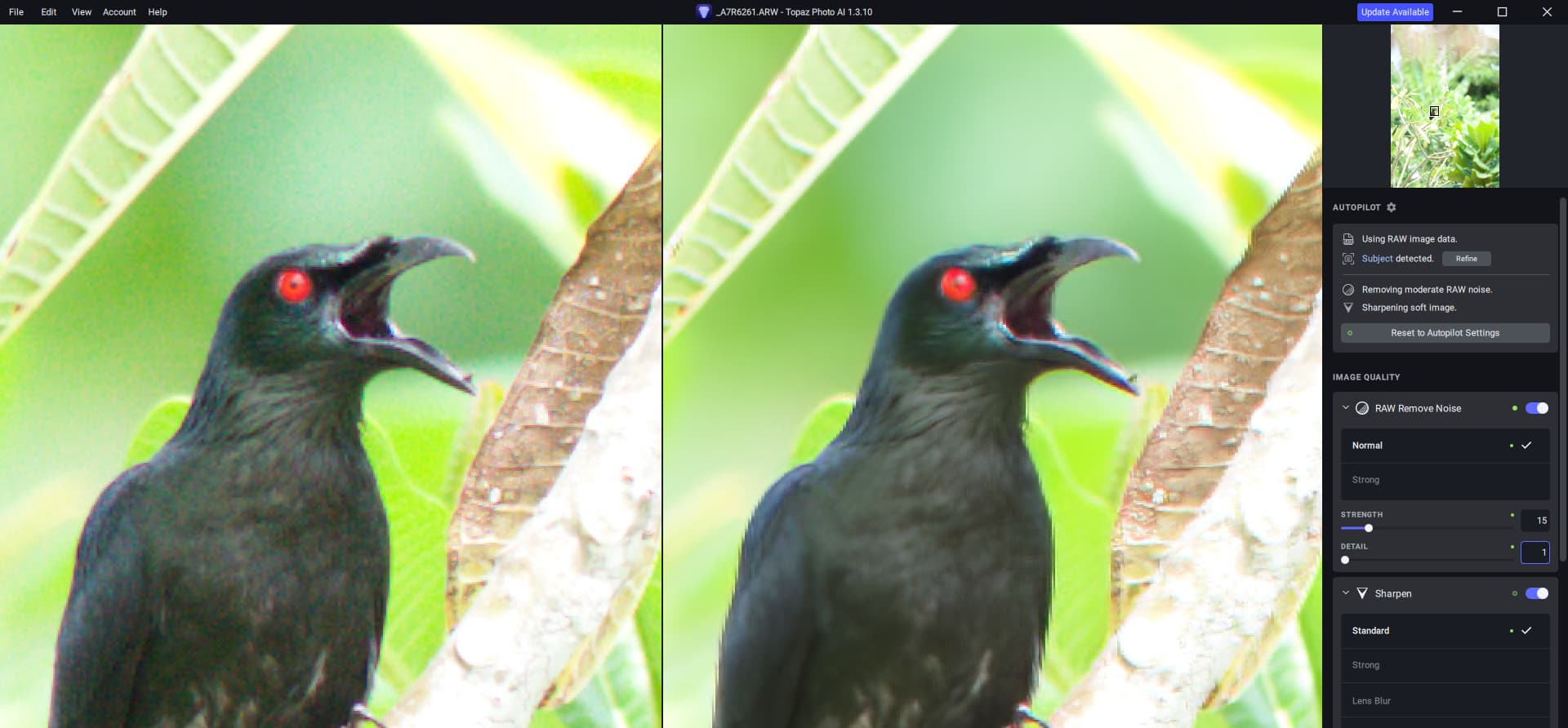

1.3.10 Subject becoming blurred after processing
the noise outside the subject was great but its affecting the eye of the bird. the center eyeball is supposed to be black, not blurry black and white

here you go Ray, adding more context below.
maybe clicking the uploaded image works? but according to fast raw viewer the bird and the eye is in focus. i also remember the sony autofocus green box got the head, i don’t no longer have a screenshot since it was deleted in my camera. but below is the one i got from my pc.
this image is a 200% zoom. i tried to see what it looks like when sharpened is only turned on. and this is what i got. its very close to the original. even the edges of the wings, they are very similar.
now if i turn on denoise and turn off sharpening.
it’s actually making it worse. It’s as if it doesn’t know that the subject is already sharp and making it worse. It’s as if all the eyes and the side wings are noise.
hi preston. i think i have enough resolution?? im zooming in at 200% though.
or are you telling me, to apply the crop to my desire, upscale, then apply denoise?
but how come I’m only having this issue with the photo above? the other photos don’t have issues.

Thanks for sharing the file. I had and was able to reproduce the issue you are seeing.
It seems that the bird is so small that Topaz Photo AI is having difficulty improving this part of the image. I would recommend the following to get a better result out of the application.
  1. Crop the image. I cropped it down to about 1.5k x 2.2k pixels.
  2. Upscale the image. I used 3x upscale.
This improved the image quality for me.
The Raw Remove Noise and Sharpen models are not good for such a small subject and improving the detail there.
Let me know if that helps and if you have further questions about this.
